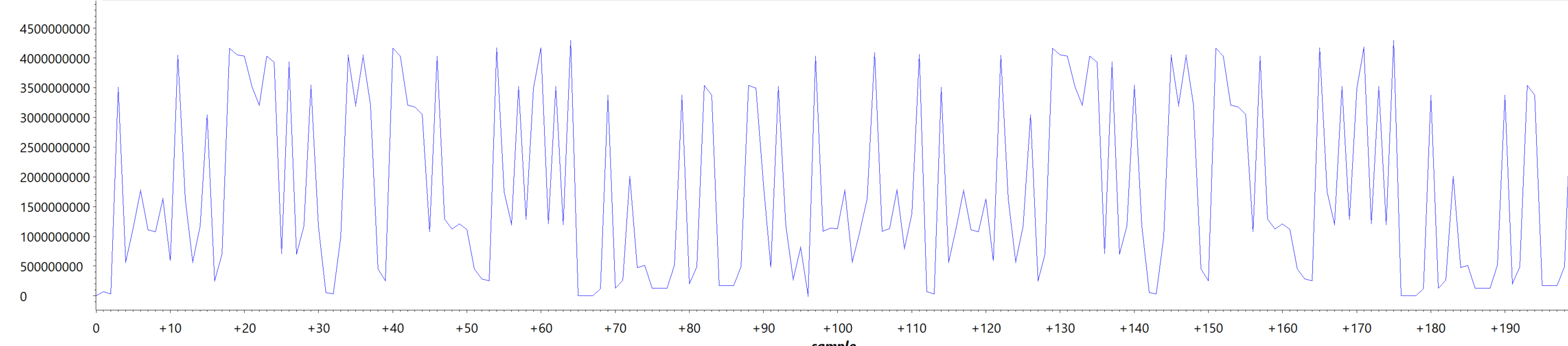

I am trying to perform an ADC on an audio signal to around 20kHz and I'm taking 512 samples at a time. I then want to perform an FFT using the CMSIS library with this signal/sample to give me 64 frequency bins. The value from each of these bins will then dictate the colour of the led (there are 128 leds, 2 per frequency bin) in a later part of the project (just so you know), its sort of a spectrum analyser.
Currently I believe my ADC is working in some form but it's doing dome strange things, meaning I've set something up thats not right or forgotten to. I'm using a pot form 0v to 3.3v, not an audio signal (the audio signal will be 3V pk-pk biased around 1.5V), currently, so I can monitor the change I'm putting into the system.
I'm tracking the data being put into the arrays; audio_samples[ ] and adc_sample[ ], using the graph function so I can see all my samples
- Why are my values are all over the place?
- How come adc_sample isn't exactly the same as audio_samples? Am i not just replicating the array outside of the interrupt?
- What would be the best sampling frequency to run at?
Here's my graph:
Here's my code;

  • If you check your setup, I think you'll notice that you only tell the ADC to perform one conversion and in the interrupt attempt to read 512 conversions.
    Robert
  • Hello Will,
    There is another issue.
    ADCClockConfigSet(ADC0_BASE, ADC_CLOCK_SRC_PLL | ADC_CLOCK_RATE_FULL, 1 );
    The ADC is being configured for PLL but the clock is not being divided. This would mean that the ADC analog would be getting a conversion frequency much much greater than what it is speced for.
    Amit

  • Thank you Robert and Amit for having patience and helping, I really appreciate it;
    Both of you were right; results were still fairly jumpy (but over much less of a range) so used ADCHardwareOversampleConfigure(ADC0_BASE,8) to smooth them out.
