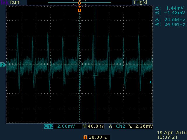

I have a design, based on the TM4C1290NCPDT.
This is giving an issue when EMC testing, with an apparent 24MHz signal giving radiated emissions way above the EU thresholds, this shows particularly at 96MHz and 120MHz, although the strength of these harmonics is likely caused by the cable lengths.
Using a magnetic field probe this was traced to the TM4C, on the board.
When testing other Stellaris and TIVA micro based designs this was not apparent.
I have checked the DK-TM4C129X Tiva C Series Connected Development Kit, and this does not do this.
I have checked a TM4C1230C3PM based design, and this does not do this.
I have checked a LM3S9B92-IQC80-C5 based design, and this does not do this.

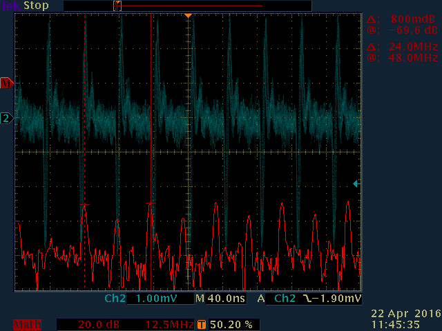

  • Hello Kevin,
    I spoke with one of my co-workers, and he is concerned about the measurement performed on the power pins and suspects that a scope is not correct equipment and the type of probe circuit for measurement. He has suggested
    1. Use a spectrometer to visualize the signal instead of a scope?
    2. We would also like to review the measurement technique on the Power IO's. Is there some kind of high pass filter being used with terminated load?
    In the meantime I am working on the deep sleep test, while we await more details from you.
    Amit
  • Amit,
    Unfortunately I don't have a spectrum analyser to look at the power pins, for your suggestion 1.
    I am not sure that I understand suggestion 2.
    Is this related to how we are measuring the 24MHz signal?
    This is using a passive magnetic field probe with a 500MHz, 5GS/s oscilloscope.
    When the probe is aligned in a particular way above the TM4C we pick up the trace as shown in my original question. When the TM4C is held in reset the 24MHz signal in the trace will disappear.
    Kevin.

    Amit's noted the potential presence of 48MHz. That appears to be the 3rd harmonic of the internal oscillator - the 24MHz is difficult to explain...
  • Hello cb1
    Following your first rule here: KISS. Let us first isolate the high frequency clock sources as the design is complicated that a 48MHz may be divided to 24MHz internally for an internal operation.
    And yes, it makes sense to take a larger spectrum of devices.

  • cb1,
    This occurs over the entire prototype build of our product.
    Kevin

  • Amit,
    I think that you are correct: The BGA package has a smaller loop for the power and return, so does not exhibit the issue to the same degree.
    I have now tested an EK-TM4C1294XL.
    This was powered from the USB debug port and have the result shown below:
    The blue trace is captured using a passive near-field H probe with a diameter of 3cm.
    The red trace is an FFT conversion of the blue trace. The markers are at 24MHz and 48MHz.
    This is almost exactly what we are seeing with my board, so it would seem that the common QFP package is the most likely cause.
    The possible reason that this is not causing issues for other people would be that some of the tracks that run underneath the micro on my board are picking this emission up and transferring it to one of the many cables that we have.
    The cable then acts as a transmitter, and may even be a good length to resonate making things worse still.
    It looks like we will need to recut our board to either use the BGA package or reduce the amount of this signal that can get onto our cables.
    Kevin
  • Hello Kevin,
    Thanks for tracking it down. And we do know the source of the signal as well.
    Amit
  • Amit,
    Was it the flash controller?
    Kevin
  • Hello Kevin,
    Yes, it is the flash controller which gets the 48MHz clock
    Amit
