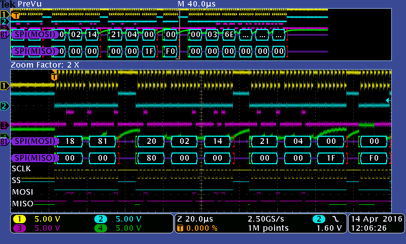

We are connecting the Hercules SPI2 to CP2120 SPI/I2C chip. We find a slow rise problem on Hercules MOSI line(CP2120 MISO line).
The green line below is the MOSI line from Hercules(CP2120 MISO line).
The odd part is that MISO line looks okay and it runs to the same locations.
Any idea why that happens?
