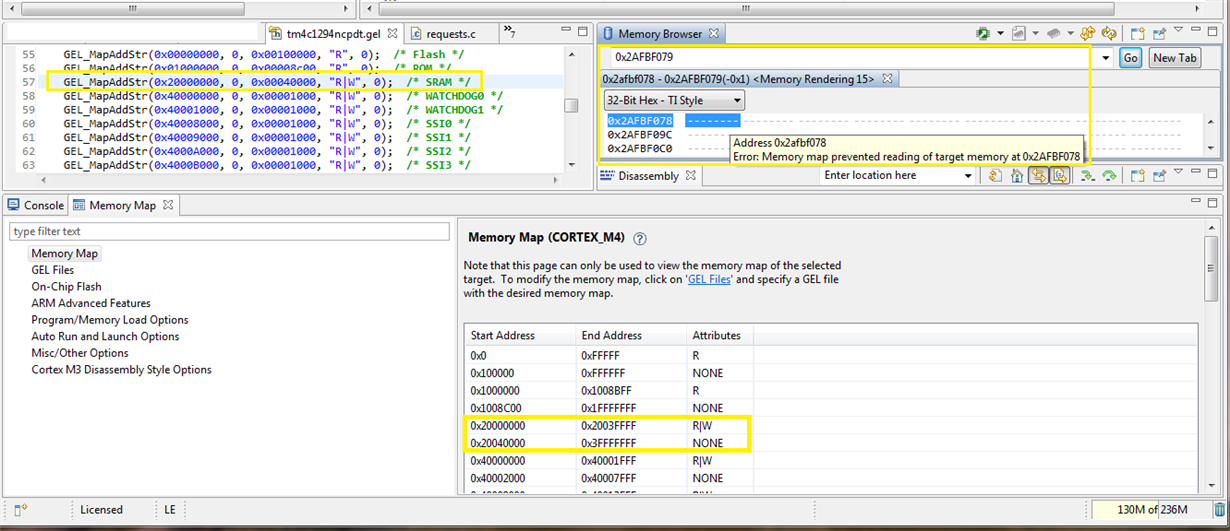

TM4c1294ncpdt Gel file shows the SRAM range as per memory map in datasheet. Notice the R/W attribute is NONE for the second part of SRAM range. Consequently this is the same precise memory location (0x2AFBF079) that persistently coincides with random bus fault 11 status. Have changed the project compiler to 5.14 and set optimization in the middle to see if that helps. Also getting same Memory Browser error if the target is running or paused.
See what I mean and thanks for looking under the hood!

    My June 18/14 Revision D data sheet page 107 table 2-5 shows SRAM range 0x2000.0000 - 0x3FFF.FFFF.
  • Ok now see table 2-4 Bit banded is memory map 0x2000.0000 - 0x2006.FFFF and Gel shows end is - 0x2003.FFFF.
  • Accordingly the fault address 0x2AFB.F079 falls in table 204 occurring in Reserved memory range 0x2235.0000 - 0x3FFF.FFFF. How to track that seems impossible.
    Oddly strange is table 2-6 bit banding memory region End is 0x2006.FFFF is roughly 458kb. Perhaps table 2-4 is also a memory map should be 0x2003.FFFF?

  • Hi Amit,
    For CB1 my rebellious attempt (factious) intended humor not intended as spell check frater. Course we are aware SRAM does not use column/row refresh cycles- hence the uprising posts. The random bus faults (11) seem integral to the GEL file SRAM R/W address range mention several posts above.
    Referring back to the datasheet memory map page 103 table 2-4 seems in conflict (useable SRAM) GEL table end address (0x2004.0000). Myself prudently checking said SRAM R/W range several times in the past, discover it incudes protected regions in EMAC0 DMA pBuf tests (Safe) memory space (>=2000.0000 && <= 0x2007.0000) abstraction layer memory constraints. Seemingly disaster occurs anytime pBufs enter address space above 2004.xxx).
    Luck would have it Transport pBufs use considerable more bytes for http header allocation than RAW pBufs. It is not documented LWIP 1.4.1 higher up layers append extra bytes to http headers of existing DMA R/W descriptor pBufs. Unless we print LWIP debug stats after LWIP initialization that would not be apparent and slower COMS exacerbate the issue of HEAP space use in excess pBufs entering protected memory space. The LWIP HEAP space has not risen above 8020 max bytes since Friday night and now hangs near 1080 used bytes.

  • Hi Amit,
    Will be sure to lower that last address a bit more 0x2003.FFFC = 262140KB.
    Seems I was not the only one fooled by memory MAP table 2.4 typo. At least it seems an error in table 2.4, the 6 should actually be a 3. That has been messing with pBuf memory guard band for quite some time. Never past had GEL file open in CCS to see why but changing 0x0004.0000 to 0x0006.FFFF or 0x0007.0000 then it becomes very clear something ain't right.
    Thanks -- this find is a huge boost!
