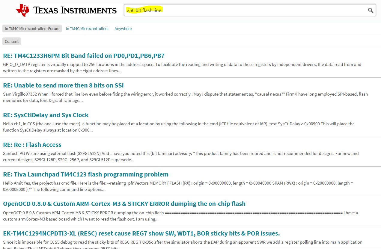

    •  256 bit flash line - might you describe/detail - I can't recall that being (past) detailed here
    • 0x00900 must "relate" to that "256 bit flash line" - again might you detail?
    My Search (via the search box - atop the forum) yielded NO mention of "256 bit flash line!"   (see below)
