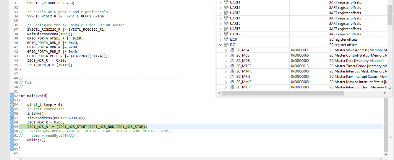

I am trying to interface BMP180 module to my TM4C123GXL microcontroller kit. Here is my code:
#include <stdint.h>
#include <stdbool.h>
#include <string.h>
#include "tm4c123gh6pm.h"
#include "wait.h"
// Addresses as per the Bosch datasheet
#define BMP180_ADDR_W 0xEE
#define BMP180_ADDR_R 0xEF
// I2C Master Control/Status Register (Read Only)
#define I2C1_MCS_BUSY 0x01
#define I2C1_MCS_ERR 0x02
// I2C Master Control/Status Register (Write Only)
#define I2C1_MCS_ACK 0x08
#define I2C1_MCS_NACK 0x00
#define I2C1_MCS_STOP 0x04
#define I2C1_MCS_START 0x02
#define I2C1_MCS_RUN 0x01
void initHw()
// Configure HW to work with 16 MHz XTAL, PLL enabled, system clock of 40 MHz
SYSCTL_RCC_R = SYSCTL_RCC_XTAL_16MHZ | SYSCTL_RCC_OSCSRC_MAIN | SYSCTL_RCC_USESYSDIV | (4 << SYSCTL_RCC_SYSDIV_S);
// Set GPIO ports to use APB (not needed since default configuration -- for clarity)
// Note UART on port A must use APB
SYSCTL_GPIOHBCTL_R = 0;
// Enable GPIO port B and E peripherals
SYSCTL_RCGC2_R |= SYSCTL_RCGC2_GPIOA;
// Configure the I2C module 1 for BMP180 sensor
SYSCTL_RCGCI2C_R |= SYSCTL_RCGCI2C_R1;
waitMicrosecond(1000);
GPIO_PORTA_AFSEL_R |= 0xC0;
GPIO_PORTA_DEN_R |= 0xC0;
GPIO_PORTA_ODR_R |= 0x80;
GPIO_PORTA_PUR_R |= 0x40;
GPIO_PORTA_PCTL_R |= ((3<<28)|(3<<24));
I2C1_MCR_R |= 0x10;
I2C1_MTPR_R = (19<<0);
void slaveAddress(uint16_t address)
I2C1_MSA_R = (address);
int main(void)
initHw();
slaveAddress(BMP180_ADDR_W);
I2C1_MDR_R = 0xEE;
I2C1_MCS_R |= (I2C1_MCS_START|I2C1_MCS_RUN|I2C1_MCS_STOP);
while(1);
i didn't use any external pull-up resistors. Activated the internal pull ups as shown in the code.
On debugging, the I2CMSA register gets updated with the value of the slave address of BMP180 i.e. 0xEE but, the I2CMDR register value doesn't change. Why is this happening??

  • Hi Chuck,
    Well according to the BMP180 Datasheet, the pull up resistor required is 4.7 KOhms for each. I don't know what is the value of the on chip resistor on the Evaluation Kit.
    My main motive was to send a read command to the sensor by the command
    writeByte(BMP180_ADDR_W, I2C1_MCS_START|I2C1_MCS_RUN|I2C1_MCS_STOP);
    I wrote the following function to write a byte to BMP180.
    void writeByte(uint8_t dataByte, uint8_t condition)
    I2C1_MDR_R = dataByte;
    I2C1_MCS_R |= condition;
    while(I2C1_MCS_R & I2C1_MCS_BUSY != 0);
    if(I2C1_MCS_R & I2C1_MCS_ERR != 0)
    I2C1_MCS_R |= I2C1_MCS_STOP;
    But, It wasn't working so to debug the problem, I checked it step-by-step and saw that the I2CMSA register is getting updated but, the I2CMDR register is not getting the value of 0xEE.
    The data rate is 100 kHz.
    No, I didn't check my result on a scope.
    From the above information, what do you most likely think is the problem? The external pull up resistors or the code?
  • Rohan,
    First, is there a reason you are not using the TivaWare drivers instead of direct register accesses? This makes lief more difficult for you since there are certain steps that are taken care of in the drivers that may be easily missed using direct register accesses. Also, reading the macro names gives explicit info regarding the the intended register writes, but without the macro definitions, I can'e explicitly state if the write is going to happen as you expect or not.
    With that stated, where do you check the I2CMDR register to see if data is written into it? I still believe it is also worth while to check the signals on the output given the situation with the pulls. If its a short distance, it may still work in standard mode so you may be ok on a limited use basis but it is always a good idea to use the external pulls on I2C.
    Can you zip your project and post it here so that I can try and debug it and get back with you with my findings?
  • I was trying to implement all the functions, starting from I2C intialization from scratch. There is no other reason for not using the TiveWare Driver. But, I will use it if this problem still persists.
    As for your second question, I debugged my program in CCS Compiler, went step-by-step and checked the value in with the "Register" tool.
     As you can see, I debugged through the I2C1MDR register, and the value didn't change as seen in the register tool from the right.
