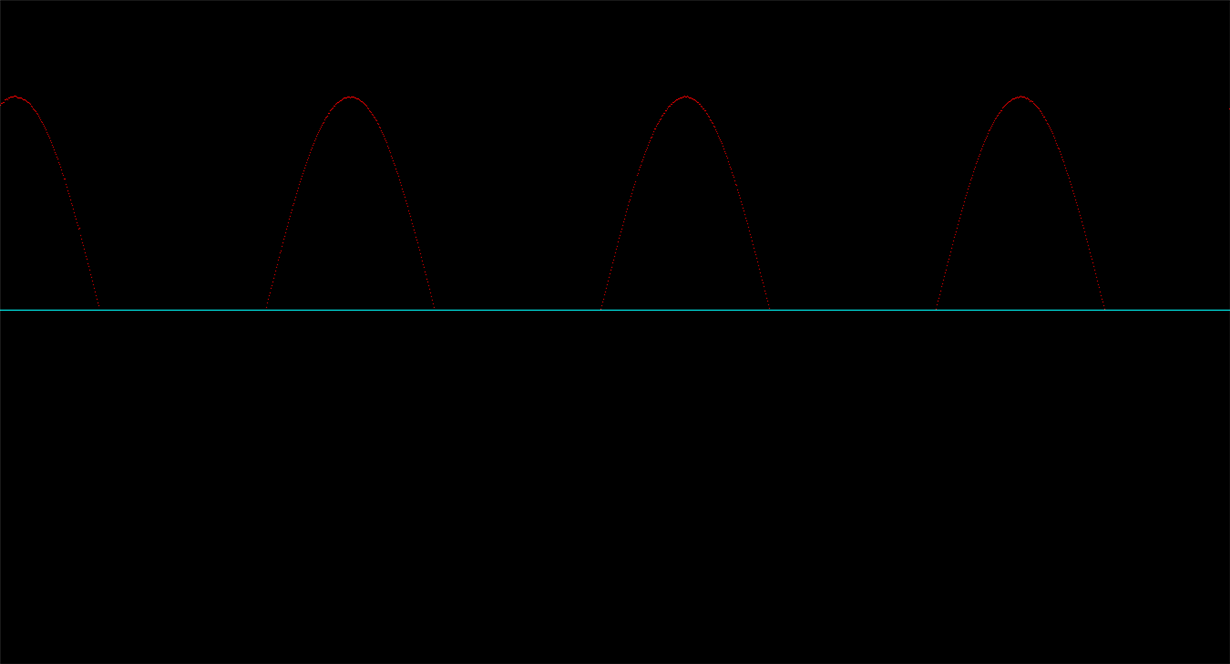

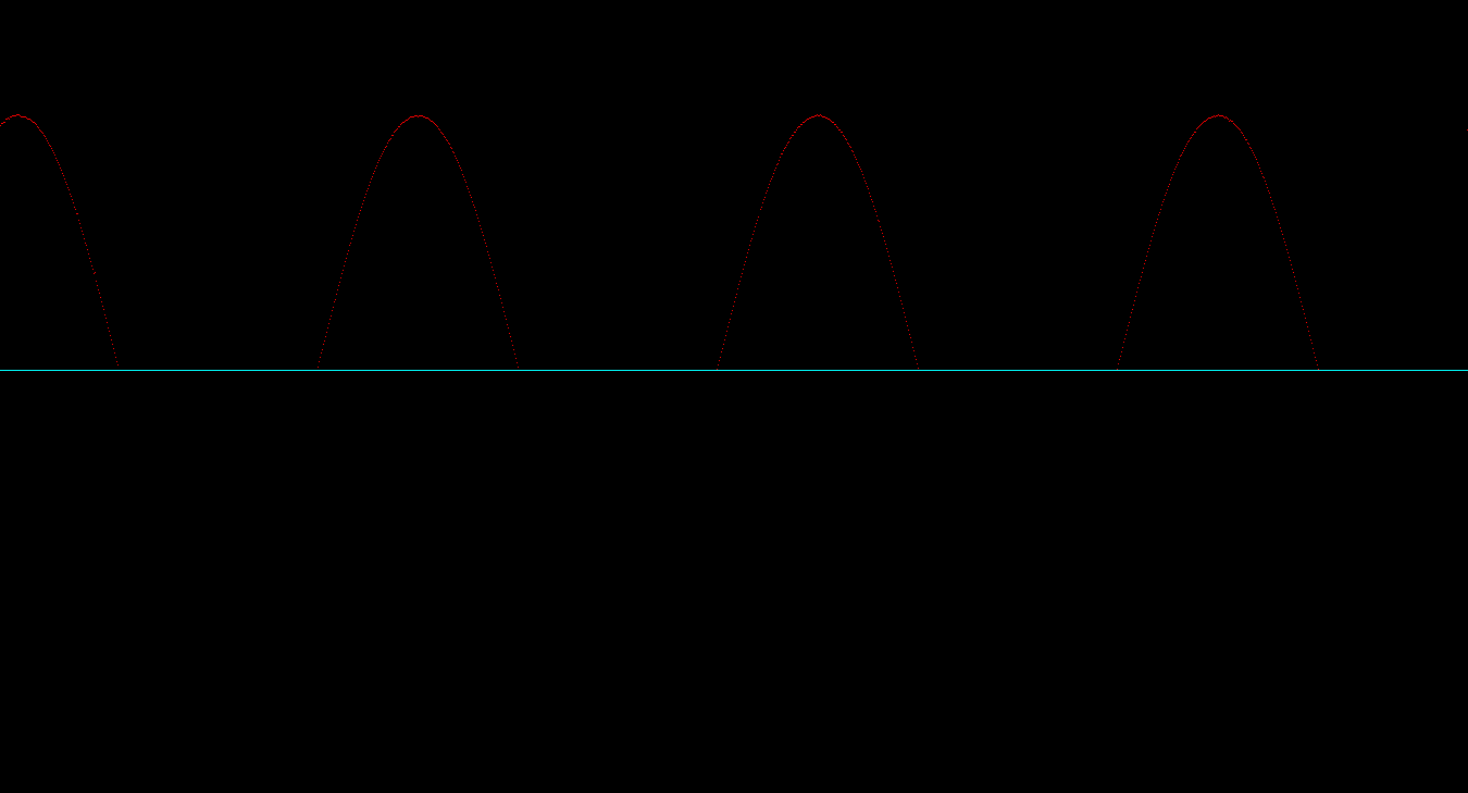

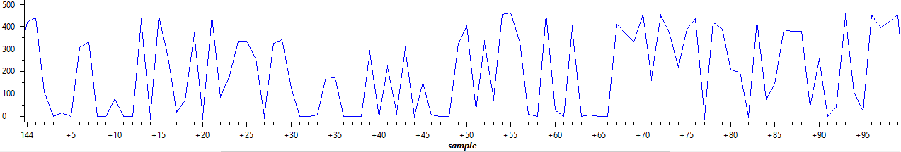

I am trying to sample to sample a 50 Hz sine signal using a timer trigger. The timer has a period of 1000 Hz. The problem is that my output looks nothing like the signal coming in.
Below is my code and corresponding graph---

    while(1){
void timer_ADC(void)
ADCProcessorTrigger(ADC0_BASE, 3);
while(!ADCIntStatus(ADC0_BASE, 3, false)) ;
ADCSequenceDataGet(ADC0_BASE, 3, pui32ADC0Value );
Voltage = (pui32ADC0Value[0]*3.3/4096);
void
Timer0IntHandler(void) {
    TimerIntClear(TIMER0_BASE,TIMER_TIMA_TIMEOUT);
    timer_ADC();
    UARTprintf("%4d\r", pui32ADC0Value[0]);
