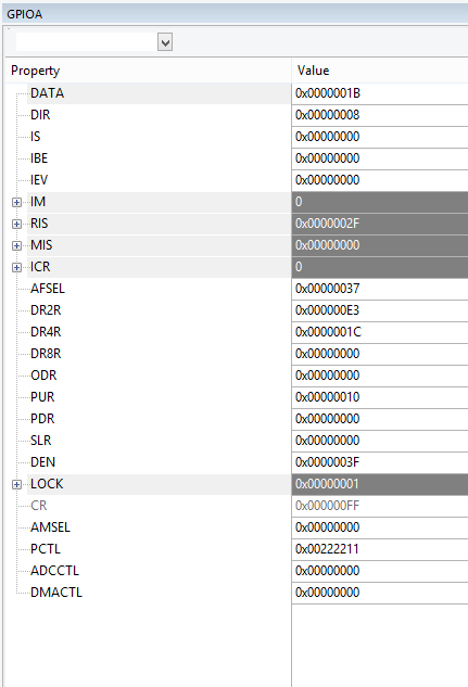

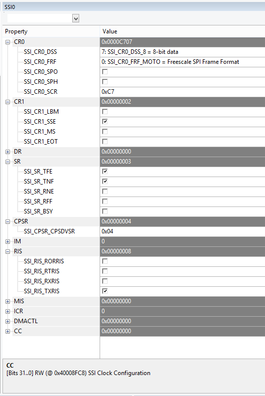

  • Hello Scott
    The initialization looks correct. The next thing is from the IDE can you take a register dump of the GPIO A Registers and SSI 0 Registers when the error message is printed, to check if there is some inadvertent configuration change.
    Also check if you can toggle the IO's manually by configuring it in GPIO Mode. This will help establish if the IO's are working correctly.

  • Everything seems to be right as far as I can see... I did notice that the mmc file did not contain the pin multiplexing set up code. i.e
    GPIOPinConfigure(GPIO_PA2_SSI0CLK);
    GPIOPinConfigure(GPIO_PA3_SSI0FSS);
    GPIOPinConfigure(GPIO_PA4_SSI0RX);
    GPIOPinConfigure(GPIO_PA5_SSI0TX);
    but adding/removing that doesn't appear to make a difference. (This was done in the power_on function) I assume this is because there is only one alternate function available on those pins.
    static
    void send_initial_clock_train(void)
        unsigned int i;
        uint32_t ui32Dat;
        /* Ensure CS is held high. */
        DESELECT();
        /* Switch the SSI TX line to a GPIO and drive it high too. */
        ROM_GPIOPinTypeGPIOOutput(SDC_GPIO_PORT_BASE, SDC_SSI_TX);
        ROM_GPIOPinWrite(SDC_GPIO_PORT_BASE, SDC_SSI_TX, SDC_SSI_TX);
    		ROM_GPIOPinWrite(SDC_GPIO_PORT_BASE, SDC_SSI_TX, 0);					 	//added this
        ROM_GPIOPinWrite(SDC_GPIO_PORT_BASE, SDC_SSI_TX, SDC_SSI_TX); 	//added this
        /* Send 10 bytes over the SSI. This causes the clock to wiggle the */
        /* required number of times. */
        for(i = 0 ; i < 10 ; i++)
            /* Write DUMMY data. SSIDataPut() waits until there is room in the */
            /* FIFO. */
            SSIDataPut(SDC_SSI_BASE, 0xFF);
            /* Flush data read during data write. */
            SSIDataGet(SDC_SSI_BASE, &ui32Dat);
        /* Revert to hardware control of the SSI TX line. */
        ROM_GPIOPinTypeSSI(SDC_GPIO_PORT_BASE, SDC_SSI_TX);
    I added the 2 lines to set the TX pin to 0 and back to 1, and this is clearly visible on the oscilloscope.
    I noticed register DR does not seem to clear after being written to. I'm not sure if this behavior is correct.
