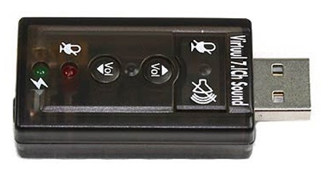

  • Hello Amit,
    Actually, I'm now testing it using 3 different USB audio cards(the below picture is the one of them), but all of the 3 USB cards show the same problem, so I suspect it was caused by the sample application.   I don't have any USB protocol analyzer, but I guess the USB audio cards were streaming the audio data into TC4C1294XL boards because the USB audio cards were working with the Windows PC.
    So, can you please look at the sample application if there's any missing steps or something else?
    BTW, when I searched the USB protocol analyzer, almost analyer are working on Windows system, so is ther any analyzer working on the TM4C1294XL board?

  • Hello Inbae
    Which external Audio Device are you using?
    Amit
  • Hello Amit,
    I'm now testing 3 different USB audio cards that were manufactured and selling in Korean market like the below pictures, but all the USB cards shows the same problem (audio playback is working well, but audio capture is not working as I raised this issue. ).   Today, I ordered another USB audio card which has the USB certification, so I'll test it using the device and let you know the testing result again.
    BTW, is the audio capture working with your USB device on 1294XL board?

  • Hello Amit,
    Today, I've got another USB audio card that has the USB certification, but the result is the same as before ( Audio playing is working, but capturing is not working. ).
    So, I think that it's not the USB compatibility issue because the 4 different USB audio cards shows the same behavior, so I guess that it's caused by some problem in the USB host audio application interface or pin out configuration on 1294XL board, etc...
