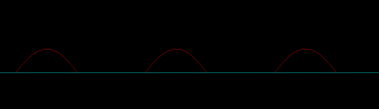

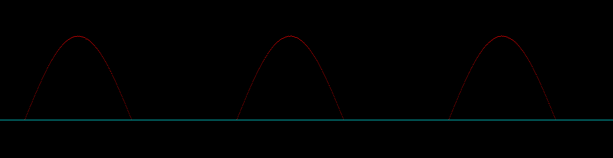

TM4C123GXL Sampling 2 channels with ADC
I am trying to sample 2 signals coming in on Channels 0 (PE3) and Channel 1 (PE2). I am currently send the same signal to both channels. However the signal from channel 0 has a lower amplitude. When I just sample channel 0 using sample sequencer 1, I don't have this issue.
Below is the code:

Plot of Channel 0, Followed by Plot of Channel 1
