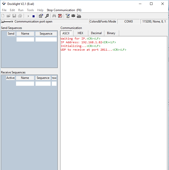

I am currently using an ek-tm4c1294xl board and trying to assign an static IP (according to existing examples and questions here in the forum). I have made the two required modifications in the lwipopts.h file and the code compiles without any errors.
When I try to run it however, the second led is not stabilizing but it is rather blinking. Through UART I am getting the following message:
Despite that, I can not ping the device from my computer.

    It sounds like maybe the gateway address is not correct being set STATIC. You might try to telnet UDP port 2011, if telnet immediately drops off very likely the port is closed or not listening.
  • Just to make sure, did you modify the network adapter setting on the PC (to which the board connects) to a static IP that is on the same subnet mask as the board's IP address?
    Can you also link the forum post that was used, to configure the board to use Static IP, or post the steps followed?

  • Hello Spyros,
    If they are under different masks, they cannot communicate. That's the reason I asked that question.
    When you say, "It should still stabilize", do you mean the LED? If yes, then which LED?
    On the EK-TM4C1294XL board, LED D4 indicates if a link is present and LED D3 blinks everytime data is transmitted/received. If LED D3 is blinking continuously, I would think that data is exchange over the Ethernet port.

  • Hello Spyros,
    I have programmed the "enet_lwip" example on a EK-TM4C1294XL board, without any modifications (that is using DHCP). LED D3 blinks continuously even after getting an IP address. And I am able access the webserver on this board. So I don't think the blinking of LED D3 indicates an error.
    Spyridon Garyfallidis said:
    I have not yet checked the communication, since I can even ping or recognize the board from my PC.
    If you can ping the board from the PC, that means you can communicate with the board. So what is the problem you are facing?
