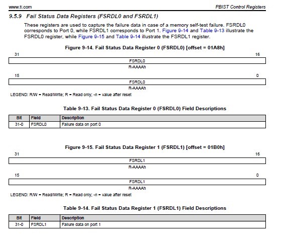

1) What is Port 0 / Port 1 mentioned in PBIST?
2) What exactly this Failure Data on Port(0/1) indicate? How is this status useful after PBIST test?

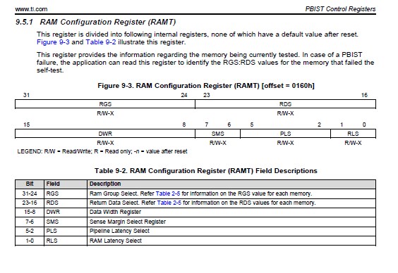

3) In this register can you please explain the fields DWR,SMS,PLS and RLS and their use in this test?
4) On occurrence of a PBIST failure, will the RGS:RDS indicate the current failure that occurred or for the First Failure (since Failure Address Status Register shows the address of the failure that occurred first)?
