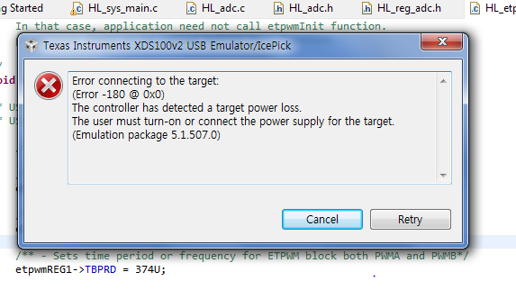

Hello, my error message look like below.
Error connecting to the target:
(Error -180 @ 0x0)
The controller has detected a target power loss.
The user must turn-on or connect the power supply for the target.
(Emulation package 5.1.507.0)

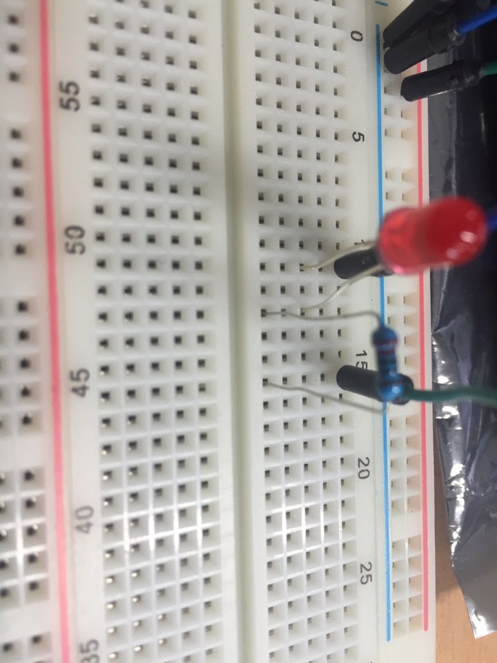

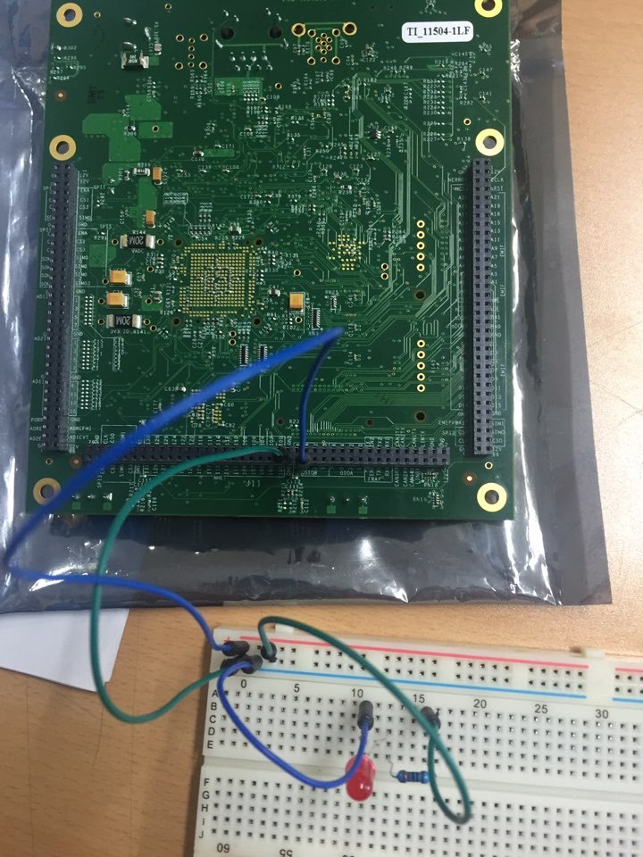

Anyway, I wanna control external LED.
So, I connect GIO pin with LED(with resistor) and  GND.
But, output message makes me terrible.

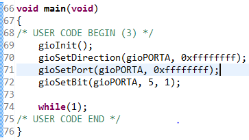

This is my code for control external LED.

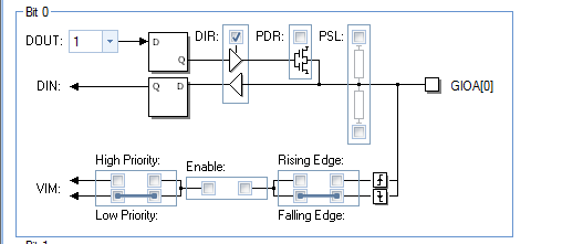

And This is HalCoGen.

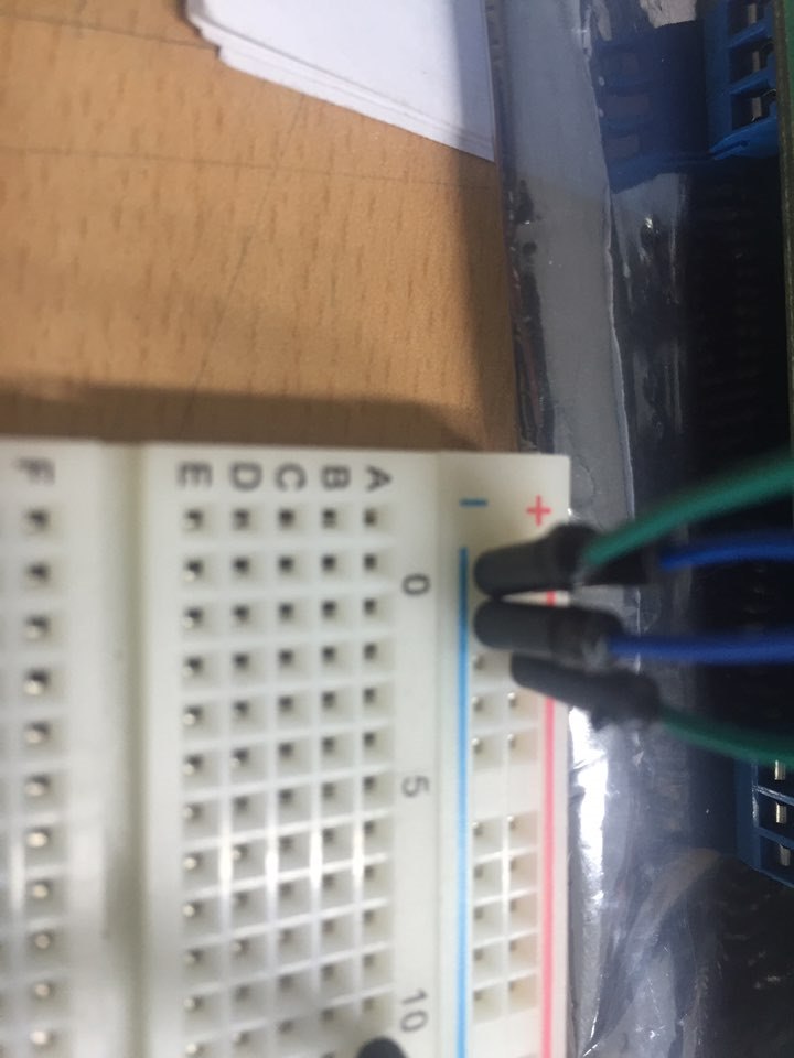

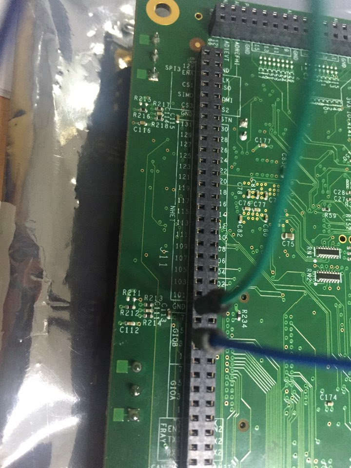

My HW Configuration looks like below.
What is the problem ?
And how can I solve this problem ?

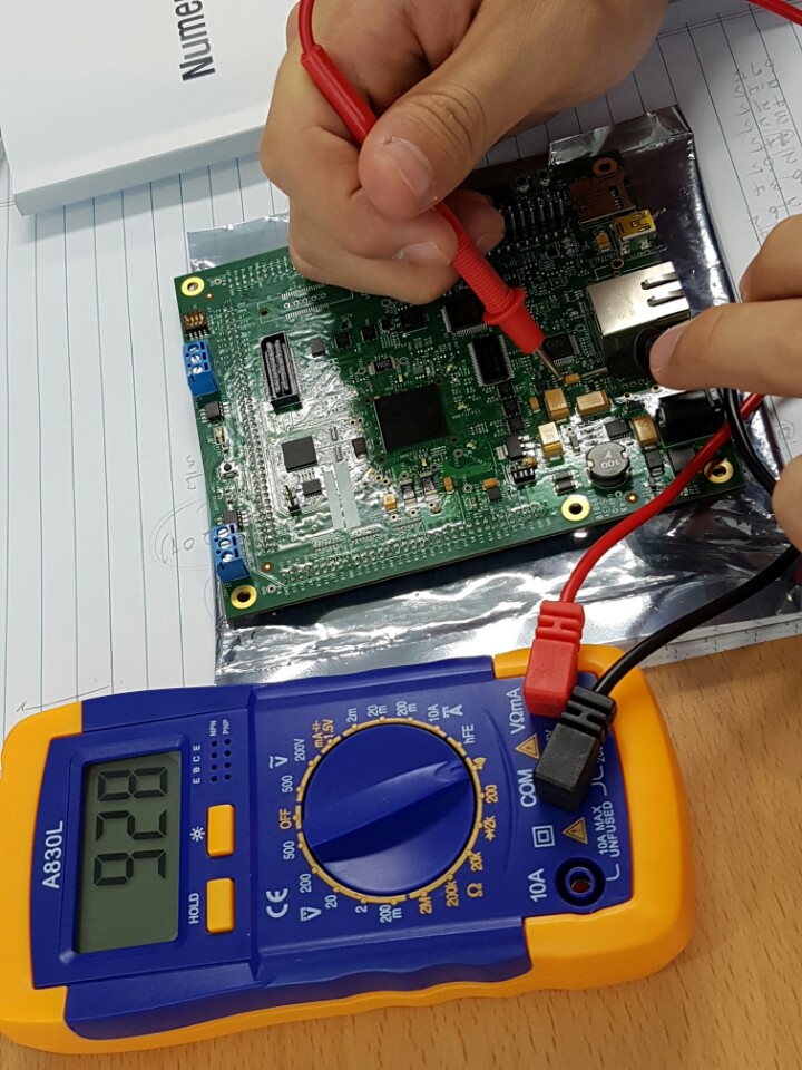

************************************************* Additional Information(After disconnect the wire) *************************************************
Still it doesn't work.
And bottom left's second internal LED was gone away(dead).
Please help me.

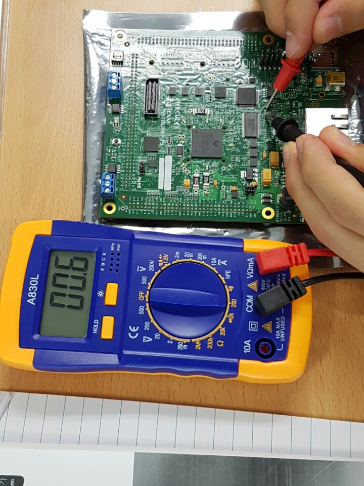

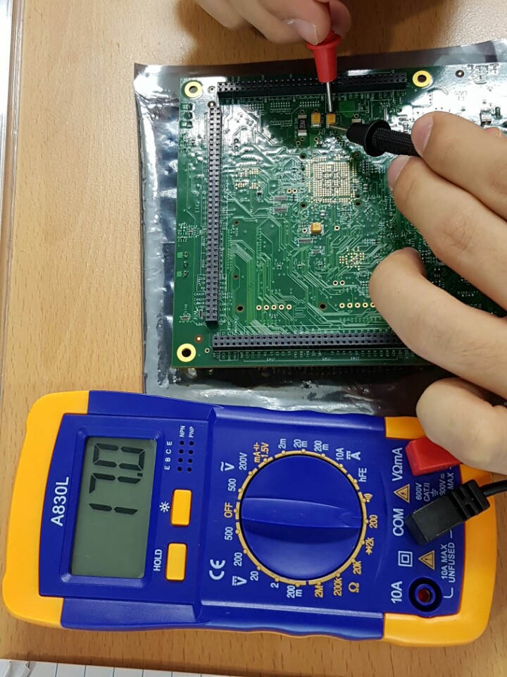

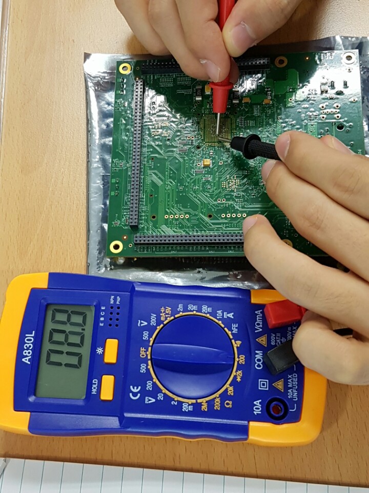

************************************************* Additional Information(Check with Multimeter) *************************************************
Almost Electric Component was dead.
Maybe the problem is bad resistor.
doing current then it's current going inf.
