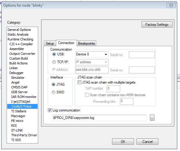

I have connected a J-Link debugger to my EK-TM4C123GXL using a Tag-Connect TC2050-IDC-NL with CLIP.
I start my IAR workbench under Windows 7. I initiated the download.
I have moved the Device/Debug switch to Device.
With just the JTAG connector I get the error 'Failed to get CPU status'.

When I plug a USB cable into the 'Device' connector, I get the message 'Target VCC failure'.

What is the correct configuration to use a J-Link with the TM4C123GXL Launchpad board?
