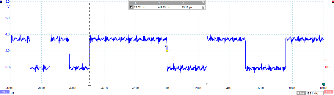

Over-length pulse sometimes generated when PWM period changed
Other Parts Discussed in Thread: TM4C1294NCPDT, MOTORWARE
I'm trying to use the PWM peripheral to generate pulse streams of varying period and a duty cycle of approx 50%. I have code which works most of the time, but sometimes when I change the period, I get an over-length pulse at the point of change - a pulse which is longer than the correct pulse for either the previous or the new period.
A specific example:
  • going from 25.05us to 50.01us period (from 12.5 to 25 us pulse length), I sometimes get a high pulse of 49.5us (see scope trace below)
  • going from 50.01us to 25.05us period (from 25 to 12.5 us pulse length), I sometimes get a high pulse of 37.4us.
In one run of 1000 changes of period, I saw the over-length pulse 14 times.
I'm using a PWM clock divisor of 64 (PWM_CC = 0x105), and the changes to the LOAD and CMP registers of the PWM are made in "Globally Synchronized" mode ("Updates to the register are delayed until the next time the counter is 0 after a synchronous update has been requested through the PWMCTL register"). As I understand it, this mode should mean that the LOAD and CMP registers both get updated at the same time, but even if they did not I can't see why I should sometimes get a period of over 62us when changing between 25 and 50us.
The code which is updating the PWM timings is:
HWREG(PWM0_BASE + pwm_gen_id + PWM_O_X_LOAD) = period - 1; // set PWM period
HWREG(PWM0_BASE + pwm_gen_id + PWM_O_X_CMPA) = period >> 1; // set PWM duty cycle to 50%
HWREG(PWM0_BASE + pwm_gen_id + PWM_O_X_GENA) = 0x8c; // drive pwm output high on load and low on CMPAdn
HWREG(PWM0_BASE + PWM_O_CTL) = pwm_gen_bit; // Synchronize pending PWM register changes the next time the counter becomes zero

  • OK, here is an standalone example project.  It generates a PWM output on PF0, which should switch cleanly between 50us and 25us period.
    This seems to only show the incorrect waveform when switching from 25us to 50us period and not the other way.  I set my scope to trigger on high pulses of over 26us to catch the errors.
    The same incorrect waveform output happens if CMPA is written before LOAD.
    pwm_issue.zip
    I have realised that both types of incorrect waveform could be explained if the CMPA register is sometimes getting updated on the cycle after LOAD.  But if I've correctly enabled and used 'global synchronisation' mode, they should be getting updated at the same time.
    Michael
  • Hello Michael
    Thanks for the project. I am able to reproduce the issue on my side and I believe it is due to the PWM Clock Divider. I would need some more debug on this issue
    Amit

  • Seemingly and inversely - the comparator match value during large frequency transitions is greater than the new frequency load value so the pulse stays high during the update. That can be seen trigging the ADC from comparator B down - expected period samples are skipped.
  • Hello Michael,
    I can now confirm that the issue is a bug in the PWM module. There is a condition where the generator timer may still count with the old load value, but the new comparator value gets loaded causing the high pulse width as shown in the example code.
    I have asked for an errata submission.
    From a workaround perspective, the suggested workaround would be to use the interrupt status to write the value of the new load and comparator, clear the raw status bit for Count of 0 and then write the Global Sync bit.
    Amit

  • I've tried the suggested workaround and it makes a big difference: the over-length pulse now happens much more frequently (possibly every time), and on both increasing and decreasing PWM period!
    I've attached the modified project, but all I have changed is to add, in the initialisation stage:
    HWREG(PWM0_BASE + PWM_GEN_0 + PWM_O_X_INTEN) = PWM_X_INTEN_INTCNTZERO;
    and before each write to PWMCTL:
    HWREG(PWM0_BASE + PWM_GEN_0 + PWM_O_X_ISC) = PWM_X_ISC_INTCNTZERO;
    while (!(HWREG(PWM0_BASE + PWM_GEN_0 + PWM_O_X_ISC) & PWM_X_ISC_INTCNTZERO)) { }
    Which is what I understood the suggested workaround to be.

  • Hello Michael,
    What you implemented is correct. It may have been a misinterpretation on my side. The divided by N clock for the PWM may be causing the issue. So I mad a change to the code above. Replacing it with
    HWREG(PWM0_BASE + PWM_GEN_0 + PWM_O_X_ISC) = PWM_X_ISC_INTCMPAD;
    while (!(HWREG(PWM0_BASE + PWM_GEN_0 + PWM_O_X_ISC) & PWM_X_ISC_INTCMPAD)) { }
    Does not show the issue on my side.
    Basically the load must be done with the Comparison A/B down (if using down mode).
    Amit

  • Yes, that does seem to work, thanks!
