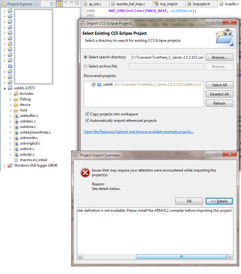

Tivaware 2.1.2.111 USB library refuses import CCS project if compiler v.5.2 definitions are no longer installed.

    The compiler version used to compile CCS project is v5.2.x This is not related to CCS version.
    Amit
  • Hi Amit,
    It seems the USBLib project for CCS was compiled v5.2.0 won't import to CCS -- don't have compiler V5.2.0 installed. That was not an issue with Tivaware USBLib bundled Tivaware 2.1.0.12573, Installed renamed to allow the updated version import while retaining the original USBLib. That way a project dependency can be toggled between different updates to see if things get better or worse in the build process.
    There are path issues between Tivaware versions crossing diverged paths and the new project include is not proving the path to older Tivaware project sub folders that exist in the project tree. Reason too have both USBLib versions in the project tree.
  • Hello BP101
    TivaWare 2.1.2.111 was compiled with v5.2.5 and this is in the Release Note document as well. I would suggest updating the compiler to 5.2.6 as well. The only other option is to manually import the files and re-create the project.
    Amit
  • Hi Amit,
    Odd being the latest compiler update available for CCS5.4 is currently v5.1.14. Perhaps Tivaware 2.1.2.111 is not compatible with CCS5.4 and only works with CCS6.0 and later?
    Otherwise could it be the update link for compilers of CCS5.4 is no longer the correct URL?

    I think in TivaWare release 2.1.1.71 the CCS version was updated to 6.0 and it 2.1.2.111 CCS sub version was updated and the Compiler Toolchain version as well

  • Thanks Amit seems I must have forgotten the feature is a manual update between versions:
    processors.wiki.ti.com/.../Compiler_Updates
  • Hello BP101,
    it is manual update between major versions. Minor versions still allow for import.
    Amit
  • Hi Amit,
    So now it's clear v.5.2 and v5.0.2 are not the same version compilers. Manual updated the feature to version 5.1.x long ago and to complicate things CCS5.4 update URL's keep vanishing after closing CCS, have to import bookmarks every time now. Likely be updating CCS v.6x very soon.
