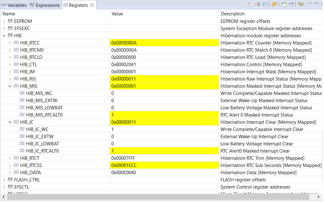

I am using  the TM4C123gh6pm evaluation board along with CCS 6.1.2 and Tivaware 2.1.2.111.  I am trying to set up the hibernate module as an RTC (No hibernation) using the internal oscillator to generate an interrupt every ten seconds.
My program never gets to the interrupt handler and  debugging shows that at match  HIB_MIS_RTCALT0 and HIB_IC_RTCALT0 are set, so I assume the interrupt is cleared as soon as its triggered. How do I avoid this from happening?
Registers:
Code:

int main(void) {
		SysCtlClockSet(SYSCTL_SYSDIV_2_5|SYSCTL_USE_PLL|SYSCTL_OSC_MAIN|SYSCTL_XTAL_16MHZ);		//Clock @ 80MHz
		SysCtlPeripheralEnable(SYSCTL_PERIPH_HIBERNATE);
		SysCtlDelay(3);
		HibernateEnableExpClk(SysCtlClockGet());
		HibernateClockConfig(HIBERNATE_OSC_LFIOSC);
		HibernateRTCEnable();
		HibernateRTCSet(0);
		HibernateRTCMatchSet(0,HibernateRTCGet()+10);
		HibernateRTCSSMatchSet(0,0);
		IntMasterEnable();
		HibernateIntEnable(HIBERNATE_INT_RTC_MATCH_0);
		HibernateIntClear(HIBERNATE_INT_PIN_WAKE | HIBERNATE_INT_LOW_BAT |HIBERNATE_INT_RTC_MATCH_0);
		HibernateRTCTrimSet(0x7FFF);
	while(1)
void Hibernate_Handler(void)
	uint32_t ui32Status;
	ui32Status = HibernateIntStatus(1);
	HibernateIntClear(ui32Status);
	HibernateRTCSet(0);
