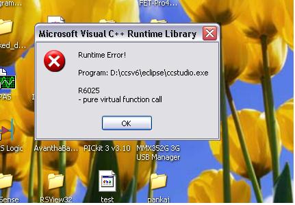

    I am facing lots of issues still. As u said regarding that issue could be due to compilation/linker error., true, but i could not figure out that. So I uninstalled CCS 6 and again tried to install it. After that reinstallation, the projest got error saying "project created in older version and needs to update in new version from CCS App center" New version of ccs is 6.1.1
    I did that also. But now i am unable to open CCS with old or new workspace. Its showing runtime error. Screen shot attached here
  • Hello Sagar
    You would need to copy the project contents manually into a new project in the new version of CCS
