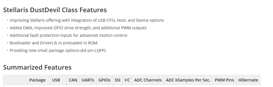

  • Hi Amit,
    As a fellow user - like poster Justin - I can confirm that (you, Amit) are absolutely correct. My firm has employed several K of "Dust Devil" devices - and that "GPIOPinConfigure()" is not valid for (our) Dust Devil devices.
    I'm uncertain of poster's device class - I recall that "Sandstorm" were earliest LM3S devices, Dust Devil & Fury later - and the problematic "Tempest" arrived last.
    I note that our small firm has long used Stellaris 9453 as the (last) version of StellarisWare able to support our LM3S & LX4F MCUs.

  • Would you be so good as to check & report the "class" of your MCU.    If it is a "Dust Devil" I can code up our Dust Devil - and report.
    We also have the first Stellaris (Sandstorm) - these were 28 pin soic devices - promised @ 1 (USD) in volume.  (a promise - btw - unkept)

    The LM3S3748 apparently is a dust devil class device.  Any assistance or example with SSIO (SPI) would be greatly appreciated.  Thank you.

  • We note that "Dust Devil" precedes Tyrannosaurus Rex, too. (only we LMI "originals" roamed the earth during that bygone era...)
  • Follows "known good" SPI set-up code which operates well w/past (departed) LM3S Dust Devil devices:
