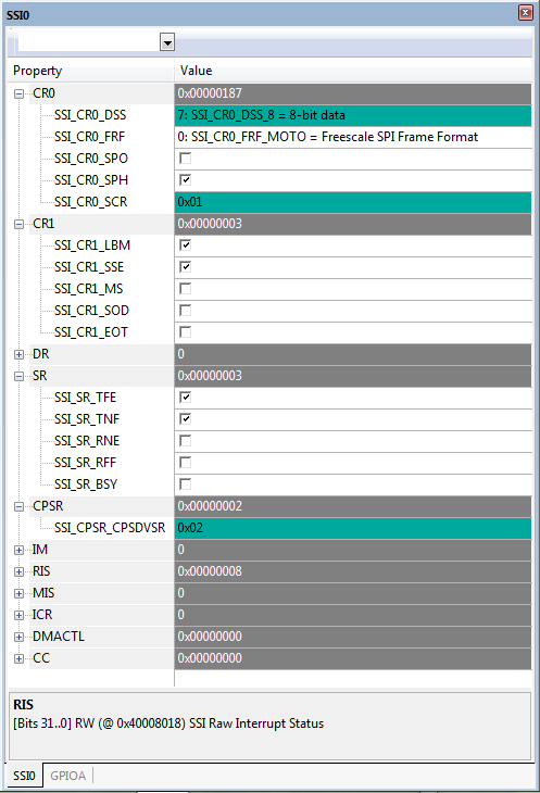

SPI receive FIFO in internal loopback mode
I am trying out the internal loopback mode of one of the SSI modules. I've noticed that when I make long enough delays in between reads from the data register, I can't get back the same data I send. I get only one value, a zero. Why is that happening. Isn't the receive FIFO there exactly for the purpose of retaining the data until it is needed?
