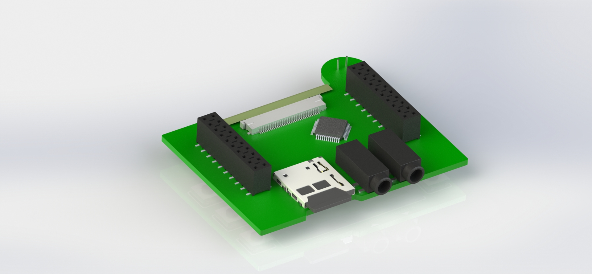

    1. The BoosterPack headers are placed on the bottom of the board. Because the OLED display size is quite big there was no chance to use through hole header here. I decided to use a SMT header like it was done on the Kentec touch screen display BoosterPack
    2. The audio codec contains a SPI interface to connect to the microprocessor. Some additional GPIOs are required from device control. I think with that approach it will be compatible with all LauchPads.
    I've added some more images here and on the webside to get a better understanding. Hope you like it.
