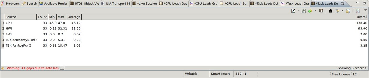

Also, the other weird thing is that the HWI consumes about 32% of the CPU time, the other 2 tasks about 0.3% and 1%  but the total CPU load is about 46%.
Thanks in advance for any clue.
    At 120MHz, 72uS is around 8500 clocks so 32% --> 2700 clocks for your interrupt. Hard to judge w/o knowing more details but easily believable.

    And the other problem with  CPU usage - yes 31% usage by HWI is OK, but why the total usage is over 45% when other tasks need only about 2% altogether? What takes up another ~13%?
    Thanks in advance for help. It is very appreciated.
    Well depending on how it's measured there is likely RTOS overhead and maybe sections of application code that do not get assigned to the appropriate bins. Or it may not be real.

    However, it did not affect the performance at all. I still lose about 30% of sinewave samples.
    Too bad I can not simply use the the execution graph in RTOS Analyzer, as the HWI takes up too much time and I lose too many samples.
    Which debugger are you using?
    If you have a debugger which supports SWO trace, such as a XDS110 or XDS200, you can use the Interrupt Profiling Configuration to traces interrupt entries and exits and time spent in each interrupt where the trace data is collected by hardware. i.e. without software overhead. See Trace Analyzer User’s Guide
