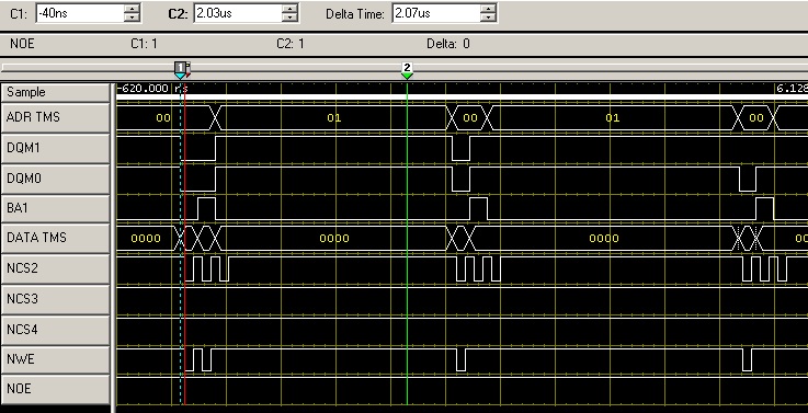

We have just done EMIF performance measurements with one Hercules Dev KIT with a Rev B mask (chip is marked "TMP570 4357BZW"). These measures
were done for asynchronous interface mode. We were happy to see that problems traced by errata #39 on Rev A mask is fully corrected for read cycles.
But for write cycles, we still have three WE pulses whatever the write type is (32 bits, 16 bits, 8 bits). This is exactly what was decribed in the forum subject "TMS570LC4357 Errata #39 clarification" where precise timing diagrams for 32/16/8 bits reads & writes were given by TI
By searching in forum we found that the problem may be due to incorrect programming of R5 core memory protection unit (MPU). So we did again the test by enabling the R5 core MPU and setting up a region for EMIF bus async (CS2, CS3, CS4) in "DEVICE" mode but we found no difference, problem was still present. We also did the same test with MPU region for EMIF bus async set to "STRONGLY_ORDERED" and we get the same problem (see joined figure). The programming of R5 core MPU is given in file also shown below (derived from same name file generated by HalCoGen)
So my question is to know if this errata of TMS570LC4357 still exists for writes cycles because the Rev B mask errata list (document spnz232 dated August 2015) indicates this Errata #39 has been corrected in Rev B mask, and it seems that there is no new errata dealing with EMIF bus in asynchronous mode for this new mask release.
This problem on write cycles leads to divide EMIF performance by a factor of 3 since for a simple 16 bits write, it takes 3 basic cycles instead of one. For instantaneous write performance, it's a problem in our real time application.
Thank you for your help
Best regards
Sylvain Balssa

    Are you in EMIF select strobe mode? I don't see three WE pulses but rather 3 nCS pulses and this leads me to think that you are in select strobe mode.
    EMIF asynchronous interface can operate in either normal mode or select strobe mode. In normal mode the nCS will be active for the entire EMIF transaction. In select strobe mode the nCS is only active during the strobe time. This is the basic difference between the two mode.
    In normal mode, as mentioned the nCS is active for an entire EMIF bus transaction. For example, if you are writing to a EMIF address, the nCS is active for the entire bus transaction while the nWE has three pulses while the nCS is active. This is the bug in revA. However, in select strobe mode, the nCS is only active during the strobe phase which means that the nCS is actually active in phase with the nWE. While we see extra nWE pulses in normal mode we would also see extra nCS in select strobe mode.
    The intended fix in revB is to suppress the extra nWE pulses during write transactions and ideally also shorten the nCS so not to waste EMIF bandwidth. However, there was some technical difficulty to shorten the extra duration of the active nCS in addition to removing the extra WE pulses. When switched to select strobe mode, these extra duration of nCS remains as two extra nCS pulses. But the nWE and nOE are not active when these extra nCS pulses are active. So from a memory access stand point this should be fine. All writes and reads to the memory should be qualified with the valid nWE and nOE.
    For read, not only were we able to remove the extra nOE pulses but also to shorten the nCS as well to improve EMIF performance/bandwidth. Therefore, during read, there is no extra nCS pulses seen in either normal or select strobe mode.
  • Hi Charles
    Thanks you so much for this detailed explanation.
    I deeply apologize for my incorrect wording for this thread title. My concern was effectively the multiple nCS pulses we got during writes (in strobe mode), and not multiple nWE pulses.
    Initally, we started to set-up EMIF bus in asynchronous normal mode but we found nCS signal much more longer than programmed. That's why for debugging purposes we switched to "strobe mode" and then, we understood why nCS was 1.5 or 3 times longer than expected, because three accesses are made even for a 16 bits word or byte write. This "reduced" write bandwith will imply to increase the EMIF internal clock frequency and also to increase our FPGA internal frequency to shorten as far as possible the write duration. Our final use of EMIF bus will use the normal mode in order to avoid multiple nCS pulses in a single write transaction.
    Finally, is TI going to open a new errata for TMS570LC4357 rev B mask to trace this functional limitation of nCS duration wider than programmed for write operations ? This would be very usefull for us in order to be able to demonstrate to certification authorities that our avionic product takes into account correctly all functional limitations listed by chip manufacturer
    Best regards
    Sylvain
  • Hi Sylvain,
    Yes, we have had a discussion internally about updating the errata to describe the nCS behavior in select strobe mode.
