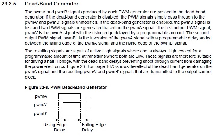

  • Again: where TM4C1294NCPDT data sheet section 23.3.5 is programmers point made clear (coupling generator output pwmA to pwmB ) and that synchronous update obviously negates dead band?
    Per 23.3.5 (dead band generator) PWM outputs are not coupled during dead band. Section 23.3.5 states generator output pwmB is dropped and generator pwmA inverted to form pwmB.

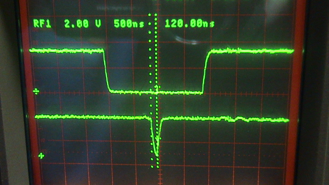

    The other thread pick bottom trace single 120ns pulse indicates DBG pwmB delay was not blending into the minimum pulse width. That DBG pulse should not be present by it's lonesome without the very same pwmA pulse width payload shown in the (top trace). Having disregard for the (posted) datasheet theory of operations overview does not go well for your argument. Instead you and others choose to nit pick on things that didn't quite match the symptoms of issue being described and illustrated.
    Be brave watch the video, pause freeze frame reveals bottom trace that very same single improper 120ns DBG pulse is present without any pulse width  payload. If pwmB signal originates from pwmA it must appear much like pwmA or something ain't working right in my book. Then try to dual DGB timers zip provided here and your entire  belief of what you thought you knew to be true will be blasted right out of the water. Be sure to hang a test probe on the 2nd generators pwmB  pin and one on the first gens pwmB pin and be completely baffled.

    That pwmA period shown first post captured top trace 120ns RED + the pulse width equals roughly 1212ns versus bottom trace showing 120ns FED appended to the very end of the period with no pulse width.
    Seems as if the DBG 10bit counter has truncated the pulse width pwmB . I suspected truncation might be due to When rather than How the pin state was being modulated. Perhaps a reason TM4C has the ability to synchronize DGB via PWM_GEN_MODE_DB_SYNC_GLOBAL where the LM3S did not. Even that newer PWM generator register configuration does not stop this anomaly from occurring on the TM4C so it seems something else is causing truncation of pwmB pulse width.

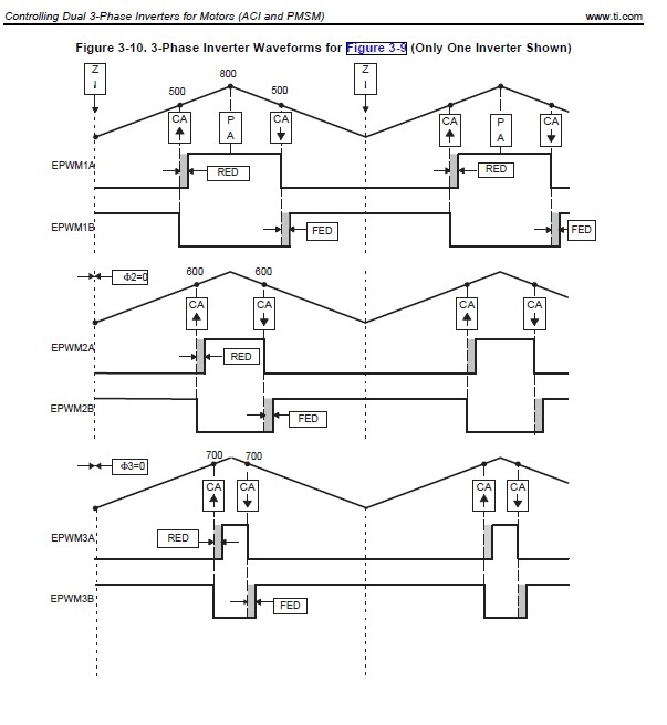

  • Again the capture below shows pwmA pulse width 1.2us to 1.4us is roughly 10 times pwmB 120ns.  Both are low and isn't that odd a 10 bit counter and pwmB pulse width is typically 10 times shorter than pwmA pulse width in the same delay period. Review F280 Enhanced PWM datasheet gives clarity to how PWM0 drops CMPB in the dead band timing diagram. It helps if we know how DBG should work to then understand that it seemingly isn't working as intended or described. The low side FET temperature rise well above high side is a good indication Sherlock Holmes would not so easily dismiss as antidotal behavior. How could anyone simply ignore that odd behavior as simply being an anomaly.
    Notice the 3 phases all have staggered pulse widths. Seems a odd idea unless done some kind of round robin circular giving each phase pair equal on time. Then bridge FETS temperatures might run more balanced. The idea this illustration shows CMPB-U/D match events are not present in the dead band. That might give a clue to what is going on with DBG's in TM4C1294 which give no timing diagrams that match the actual programmed behavior. The problem TM4C/LM3S and FED is not always part of the pulse width derived from pwmA (shown in this illustration) and instead is a rogue 10 bit counter firing event appended to each period end that only includes the derived pwmA pulse once per 3.8ms PWM update cycle. The 3.8ms is relative to rotor speed duty cycle and faster speeds produce shorter full periods in switched commutation.
  • Difficult to comprehend pwmB 10 bit counter seems to inject pulses at the end of all (remaining) 80us periods accept the very 1st 80us period. Each 3.8ms cycle FED appears as a one shot event of an 80us period 12.5kHz accept for full dead delay period 240us they line up real time but impossible to capture acquisition time into scope memory. Dead band does protect each 1/2 bridge from shoot through but produces uneven symmetry pwmA to pwmB and very different from timing illustrated above post figure 3-10.
  • That diagram is exactly what is to be expected from deadband. Nothing odd about it. Certainly no indication of anything round robin.
    You've yet to explain what signals those scope traces are.
    Robert
  • The diagram above is showing (properly operating) dead band generators timing F280x ePWM. That does not infer the TM4C/LM3S dead band generators are or were ever operating correctly in the first place. And or some kind of SW anomaly could be setting a cascade failure into motion.
    The scope capture above proves dead band pwmB output is producing single FED delay periods from the input signal pwmA inverted and delayed (minus any pulse width) shown in the timing diagram. That indicates the 10 bit counter (pwmB DBG) is adding delay periods at the wrong place relative to the pulse width of pwmA. That does not indicate a strict period is derived from pwmA and pwmB delay is somehow being append to every other generator period after and only after the initial RED pulse width changes of edge position. It also seems as if the output signals pwmA and pwmB are loosing center aligned positioning show statically centered in the diagram when the pulse width is being stripped from pwmB output.
    Could it be PWM0 pwmB input is decoupling from pwmA and triggering the 10 bit DBG counter directly from PWM0 generator at those intervals. That might explain how the succeeding 80us periods then have 120ns FED delay appended in place of the pulse width changes shown occurring in pwmA.
    Typically in motor commutation engineers don't maintain staggered PWM generator periods as depicted in the diagram. Reason for mentioning such pattern would not be proper unless in some kind rotation. The programming example (ePWM) simply states initial generator periods. May give period staggering a try latter as the duty cycle will quickly adjust all 3 in the waveform update call relative to phase current demand. Staggering periods could perhaps improve motor rotation in one direction during the initial startup cycle. There must have been some reason for staggering not mentioned in the programming example.
  • TM4C data sheet section 23.3.5:
    If the dead-band generator is enabled, the pwmB signal is lost and two PWM signals are generated based on the pwmA signal.
