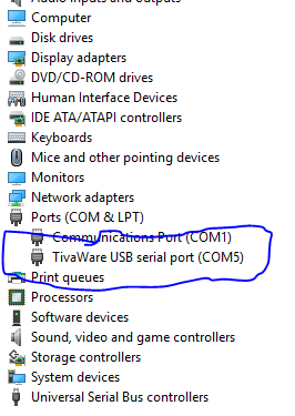

TM4C1290NCPDT USB SERIAL DRIVER Compatibility issue with Windows 10. TEXAS is lagging Behind !!!
Now almost about 10 month gone, and now Windows 10 is fully tested and released worldwide, Driver has to be updated and supports Windows 10 as we are facing difficulties in customer support. Our Products are already in the market and We got s many complaints regarding Windows 8 and higher compatibly. Our Products with TIVA Serial USB is not being detected with Windows 8 and Windows 10. Texas should come-out with the compatible drivers for entire Lineup micro controllers. Please do need full ASAP. Is there any other patch for the existing drivers then please update ASAP. Others Third Party vendors like FTDI , and other USB driver vendor are upto date with Windows 10.Why not TEXAS???? Why TEXAS is lagging behind all other Competitor Microcontroller??????

    I see a long paragraph and not a single sentence describing the issue, a single image showing what windows device manager sees for the drivers being used as?

    The tactical patch has been updated on the forum thread and will be in TivaWare release 2.1.3 (which is scheduled for 2Q-3Q of this year)
    e2e.ti.com/.../463167
    Amit
  • Still the same Issue is being occurred and our device still doesn't perform as fine as in windows 7 .
    Ya one i thing,I didnt found any change in the Old drivers that are available online  and New Drivers you gave us as patch !!!
    Is it correct.?
    i have attached both files

    CAn you please help me out our devices still not communicate with the Windows 10 PC ya TIVA ware Serial Port is being installed successfully but didnt communicated
    Some other users had complaints about same problem - and there is on response confirmed by the original poster here.
  • Hello Smit
    You would need to debug what exactly is happening in the application. Only then can we help better knowing where to look for as the sample examples work with the new drivers

    And regarding the application ok can you help me my casting my computer at your place with having windows 10 and with windows 7 so that by your side you can inspect and is there any specific method to install your patch ? Or I need to edit my code !!
  • Hello Smit,
    As Petrei pointed out, clean out the windows USB manager and then retry. Since you would have the source code, you would first need to debug the issue w.r.t the USBLIB and the PC application.
    Once you narrow it down to a particular section of the usblib code then we can be more productive to replicate the issue. Please note that we cannot take customer end systems without NDA's or Export control regulations.
