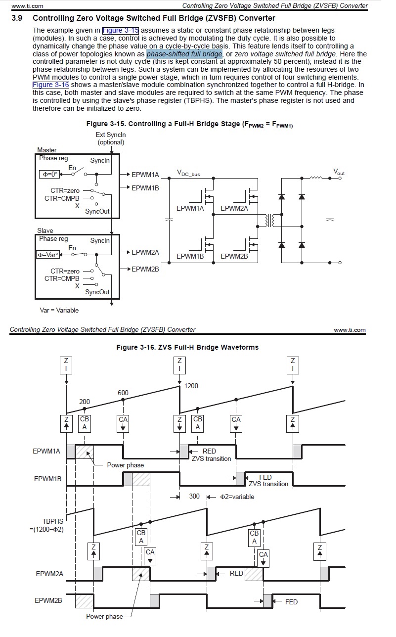

  • Not an uncommon configuration 2 PWM modules phase shifted H bridge yet it is most efficient 4 FETS  constant 50% duty with dead band protection. Perhaps Piccolo may use the term module versus TM4C generators.
  • That's a full bridge not a 1/2 bridge, a rather different setup. It also uses complementary drive waveforms.
    Robert
  • And isn't that the best way to achieve an 180 degree phase shift as the poster had requested "What is the best way to achieve 180 phase shift two PWM outputs?"
    Poster also mentions desired his model testing zero voltage switching (ZVSFB) -- seemingly only achievable Full H bridge with fixed 50% duty cycle.
    Half model is claimed possible TM4C1294 but I wouldn't trust the dead band generator after filming random undesired FED pulses on the rising edge pwmA. Perhaps as CB1 stated the FET driver with dead band could better protect the 1/2 H bridge but then again that model wouldn't be ZVS.
    Recall Tivaware text suggest some MCU's have dual PWM modules and perhaps could be made to sync update from PWM0 CNT0 pulse and load PWM1 comparator B 180 out of phase much like the Piccolo F280x easily achieves.
    After all the desire is for clean sounding water falls without any random PWM noise producing poor DC or random FET burn outs on full H bridge startup. That seems the draw back of ZVSFB (startup) and special dead band precautions must be adhered to during FET IAS periods.
