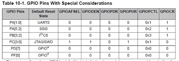

The problem is that I do not see anything going on the SPI bus, although everything appears to be fine. I went to microcontroller datasheet to know what happens. Here is where my investigation is :
To enable and initialize the SSI, the following steps are necessary:
1. Enable the SSI module using the RCGCSSI register (see page 346).
SYSCTL_RCGCSSI_R0 1 SSI Module 0 Run Mode Clock Gating Control => SSI0 enabled
2. Enable the clock to the appropriate GPIO module via the RCGCGPIO register (see page 340).
To find out which GPIO port to enable, refer to Table 23-5 on page 1351.
SYSCTL_RCGCGPIO_R3 1 GPIO Port D Run Mode Clock Gating Control => USB0
SYSCTL_RCGCGPIO_R0 1 GPIO Port A Run Mode Clock Gating Control => SSI0 : SSI0Clk = A2, SSI0Fss = A3, SSI0Rx = A4, SSI0Tx = A5
3. Set the GPIO AFSEL bits for the appropriate pins (see page 671). To determine which GPIOs to
configure, see Table 23-4 on page 1344.
GPIO_AFSEL 0x0000003C GPIO Alternate Function Select [Memory Mapped]
0b111100 => A2+A3+A4+A5 are linked to alternate function
4. Configure the PMCn fields in the GPIOPCTL register to assign the SSI signals to the appropriate
pins. See page 688 and Table 23-5 on page 1351.
GPIO_PCTL 0x00222211 GPIO Port Control [Memory Mapped]
PMC2 = 0x2 => SSI0
PMC3 = 0x2 => SSI0
PMC4 = 0x2 => SSI0
PMC5 = 0x2 => SSI0
5. Program the GPIODEN register to enable the pin's digital function. In addition, the drive strength,
drain select and pull-up/pull-down functions must be configured. Refer to “General-Purpose
Input/Outputs (GPIOs)” on page 649 for more information.
GPIO_DEN 0x0000003C GPIO Digital Enable [Memory Mapped] => The digital functions for the pins A2 to A5 are enabled
=> not clear : should be 0 ??

  • Hello Adrien,
    Which LaunchPad are you using - TM4C123 based or TM4C129 based?
    If you only want to send commands and receive messages, then using the UART would be much easier and it is the standard method used. On the Launchpad, you will use the same USB port that is used for programming.
    As far as setting up the SPI is concerned, did you refer the examples in the folder "/examples/peripherals/ssi" of TivaWare?
    Sai
  • Hello Sai,
    I am using the TM4C123 based.
    Regarding the USB versus UART, I do not have any serial to USB part so virtual com port was perfect for my need.
    Finally, to setup my spi, i followed the provided code un examples/peripherals/ssi, spi_master
    I added padConfigSet for pull up. That is it.
