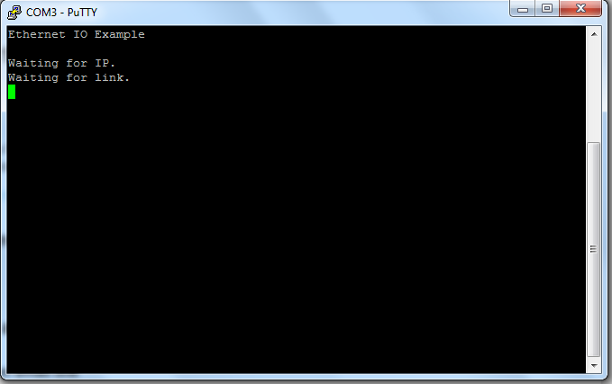

So I have tried debugging the network status using a terminal program (putty in this case) and it seems like it doesn't obtain the ip adress, just like this:
I have read that the terminal must to shows connection data like: launchpad's MAC, IP, CIK code, etc.

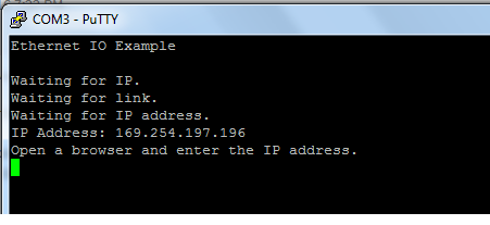

  • Hi fellows, look I've been trying to make it works until the putty shows me this data:
    So I realize the board was running the enet_io example, the one that embbed the following webiste:

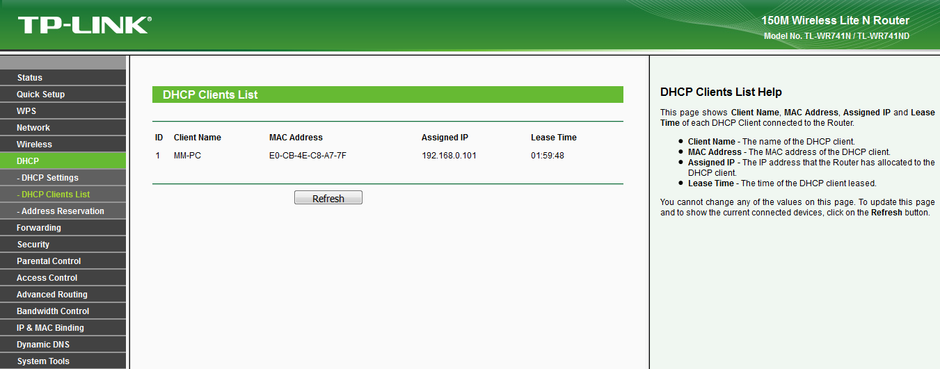

    Probably this program is loaded since the last time I open the CCS studio. I wanted to know if this is related to the exosite app I'm trying to run. Finally i have looking up my router settings and I realised that in the DHCP clients it doesn't detect the ti launchpad's MAC adress as you see in the following picture:
    As you see the only MAC adress registred is the desktop pc's one. Could this be the reason why the exosite app doesn't work?

  • Hi Martin,
    169.254.197.196 looks like launch pad self assigned IP address and not from your routers DHCP pool. A range of client addresses your DHCP sever can assign to devices in your local network like range 192.168.10. 1 - 192.168.10.20 mask 255.255.255.0. That gives your router modem etc.. 19 IP addresses for DHCP auto assignment.
