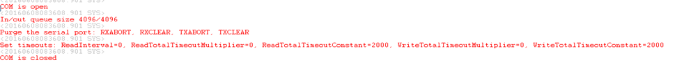

But communication is not being started in Some PC it will work as such in my PC it will work smoothly but in my colleague it will not work as such we found the Port is not being open successfully by that communication software and we monitor the action in background around the port is like below.
COM was opened and Purge the serial port is being happening whats exactly it mean???
and how it will happen with any communication system.
Please guide me for the same.

  • 1) Yes it is in Existing TIVA ware Version.
    2) No but in some system it will work and others dont.(we have observed with Windows 7 32 bit it works fine but in Windows 7 64bit it will not work)
    3) Drivers are installed perfectly as it shows the TIVA Ware COM Port and its number too.
    4)we have used Modscan 32 and various other.
