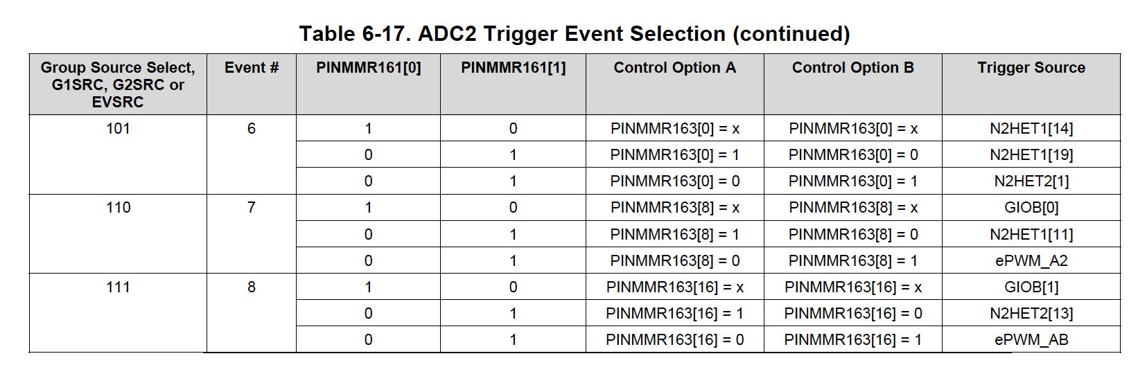

Hi there,
I need to trigger my ADC2 event group with ePWM_A2 event. However, when I look at the table on page 167 of the TRM, Control Option A and Control Option B have the same PINMMR163[8]. I have tried to set PINMMR163[8] = 0 and it did not work.
Can you please provide me some direction how to do the configuration here? Thank you!
Update:
I actually figured it out. The Control Option B should be PINMMR163[9] = 1.
However, I need to trigger another channel in ADC1 with ePWM_B event, which should be configured with PINMMR162[16] = 0 and PINMMR162[17] = 1. it seems there is some kind of iomm conflict between ADC2/ePWM_A2 and ADC1/ePWM_B. If I configure one of them alone, everything is fine. If I configure both, the system would crash shortly after boot.
Shuozhi
    Thanks for identifying the typo in the table 7-17. I have submitted a bug report for this document and it will be addressed in the next update.
    The control settings for triggering ADC1 with ePWM_B is PINMMR161[8:9] = "01" from table 7-16. The settings that you mentioned are for selecting ePWM_B to trigger ADC2, which is essentially overriding the earlier selection of ePWM_A2 for ADC2.
    Sunil

    In my application, I need to have three ADC groups out of two ADC modules triggered by three different PWM events.The issue is in the group source selection configuration. When I configure all three of them, I had a system crash that cannot be traced by GDB. If I only configure any two of them, which means the third group is not triggered, everything is fine and I can read all the ADC data from the triggered two groups.
    Before this failure, I used to have three groups from the same ADC module, which worked perfectly. However, when we designed the board, we decided to use two ADC modules and I ran into this trouble.
    If possible, can you help me quickly verify my configuration?
    Here is my configuration:

  • Actually I found it's my bad. My ISR handler was not updated when I switch from ADC1 to ADC2, in which some memory is corrupted.
    Thank you very much!
