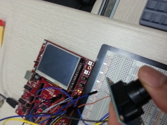

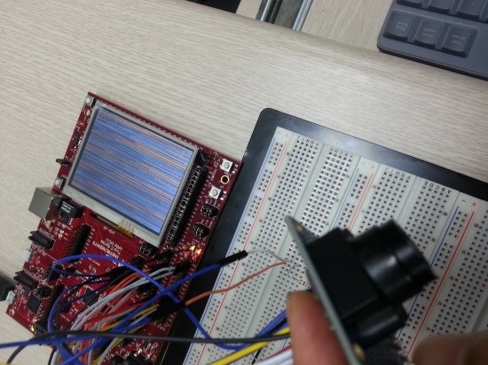

hello there, this walter kim. I have a serious problem with ov7670
I'm currently using tm4c129xnczad board and ov7670 module with al422b fifo
i have printed out my RGB value on LCD which i got from ov7670 in bayer pattern
however, the outcome of the image has problem.
good thing is that it recognizes when camera is blocked, the LCD turns to black.
below is my source code, please revise and give some comments if you could.
I appreciate your help thank you very much.
walter

  • Would it not aid your helpers ability to respond if you'd employ a, "More regular, better defined, Test Pattern?"   The image you've used is poorly defined and your screen is not optimally positioned for easy, helper viewing.
    Many such "Test Patterns" are on the "net" and were past used @ TV stations for camera focus & gain settings.
    Few here are OV experts - you'd do well to direct these questions to OV as well...
    As I recall - OV7670 has a "semi-standard" camera interface - supported by other ARM MCUs.   (yet not directly by this vendor...)
  • Hello Walter
    Did you check the signal timing as expected by the FIFO data sheet and what is being generated by the TM4C12x device?
    Amit
