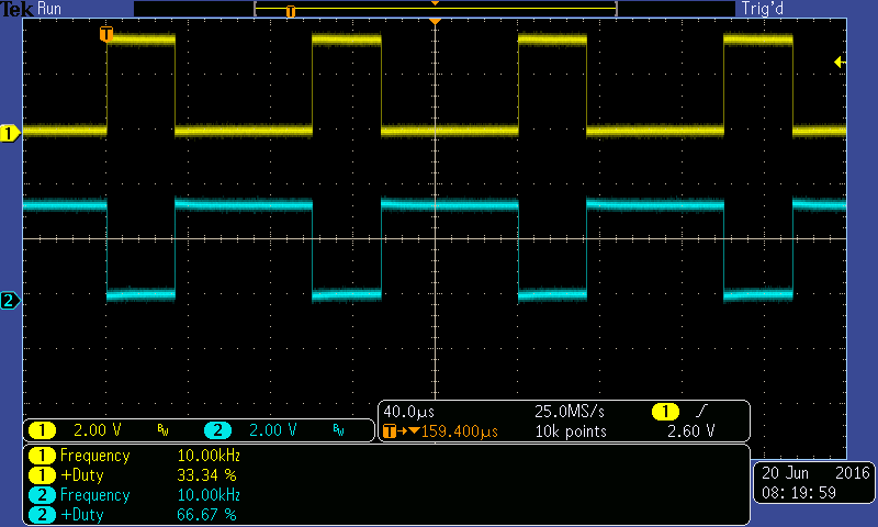

  • Sagar Ghute said:
    The duty cycle of PWMout0 is 33% and duty cycle of PWMout1 is 66%. It mean PWMout1 is inverted signal of PWMout0.
    No, no, no my friend - it does NOT mean ANY such inversion!   Instead - the duty cycle of each PWM output is completely variable - and controllable by code.
    The fact that you are (now) able to achieve a "variation" in pulse width suggests that there is no (unwanted) short circuit between your chosen PWM output pins.
    If (and only if) you had enabled "dead-band" then (and only then) would the second PWM Output be a "true" inversion of the first PWM output.   (and the 2nd PWM output would be wider than the first - by the extent of the dead-band (if any) which you employ.
    If there's time later I'll provide a scope cap - reflecting the exact code I've supplied - to "quiet" your doubt...
  • Here now - scope caps - first illustrating (completely) independent PWM Duty Cycle and second illustrating the (intrusion) of "dead-band."
    "Normal" PWM Generator - dual channel - independent duty cycle (very much) possible.  (in play - here!)

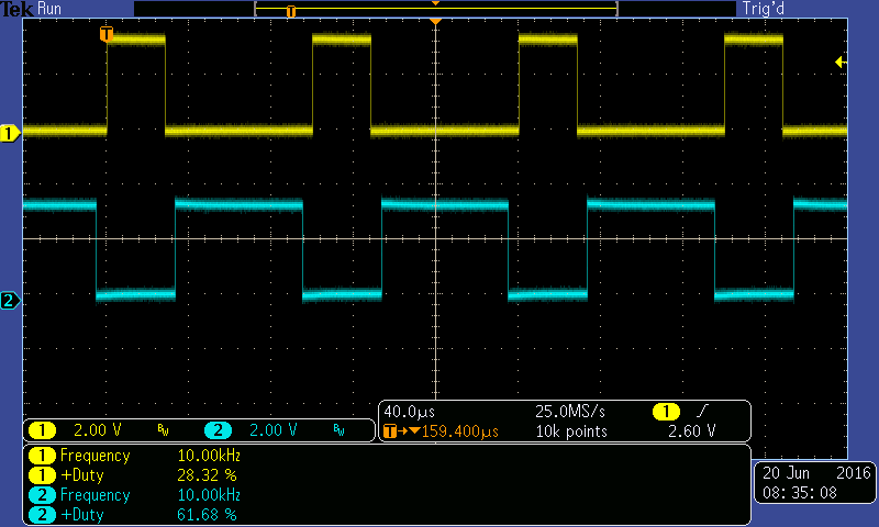

    Here now the identical waveforms - but w/"Dead-Band" inserted.   Note (now) the signal inversion!   Kill the dead-band command to "fix."   Note that "dead-band" has been dialed to "0" (both lead & lag.)
    And here now "dead-band" w/both "lead/lag" dialed to 200 PWM clocks.   Note that duty cycle of PWM_A has "shrunk" while that of PWM_B (blue) has increased!
    This "shrinkage" of the more "active" PWM Channel (Ch_A) is not "universal" among ARM MCU vendors.   We've noted that it IS possible to maintain the duty cycle of PWM_A while fully/properly "bracketing" PWM_A w/in PWM_B.   The impact of this vendor's implementation (shrinking PWM_A) is that "FULL ON" PWM Duty will be less than (sometimes) required.   (note that most all ARM based PWM Generators are "challenged" by "severe" Duty Cycles. (those @ near 0 & near 100%)

  • You have - quite clearly - enabled "Dead-Band" which causes the blue trace (Ch2) to respond as an inversion of yellow (Ch1)!
    I noted such in my posting - search for "deadband" w/in your code - and eliminate it to "escape" this unwanted "complementary" output.
