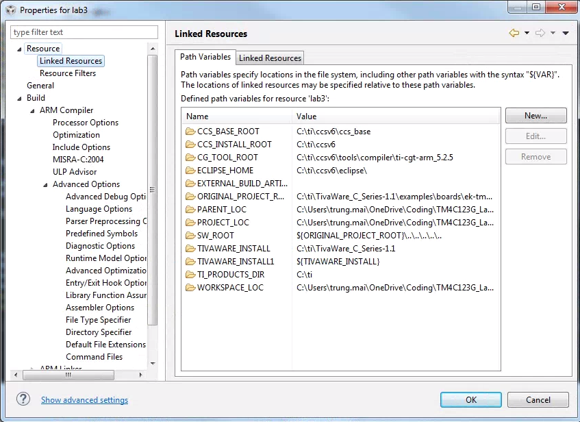

  1. Created a path variable named SW_ROOT with the value of ${ORIGINAL_PROJECT_ROOT}\..\..\..\..\.. in Project Properties/Resource/Linked Resources/[Path Variables tab]
  2. Created linked resource to buttons.c and buttons.h in Project Properties/Resource/Linked Resources/[Linked Resources tab]. If I click on the edit button, it shows the location as: SW_ROOT\examples\boards\ek-tm4c123gxl\drivers\buttons.c and the resolved location to the correct folder.
  3. Added the #include search path in Project Properties/Build/ARM Compiler/Include Options. The two search paths I’ve included were “${SW_ROOT}” and “${SW_ROOT}/examples/boards/ek-tm4c123gxl”.
  4. Created Build Variables in Project Properties/Build/[Variables tab]. The two build variables I created were ORIGINAL_PROJECT_ROOT (type Directory and value C:/ti/TivaWare_C_Series-1.1/examples/boards/ek-tm4c123gxl/qs-rgb/ccs) and SW_ROOT (type Directory and value ${ORIGINAL_PROJECT_ROOT}/../../../../..).

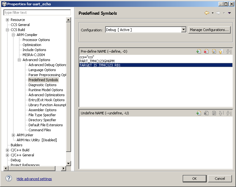

    For the ROM_* functions to be resolved, a predefined macro of the form TARGET_IS_* needs to be defined before ROM.h is included, which identifies the type and revision of the device.
    If you look at a TivaWare example for the EK-TM4C123GXL, e.g. uart_echo, the TARGET_IS_TM4C123_RB1 pre-defined name is set in the CCS project properties:
    If you add the pre-defined symbol TARGET_IS_TM4C123_RB the error about the undefined symbol ROM_SysCtlPeripheralEnable should be fixed.

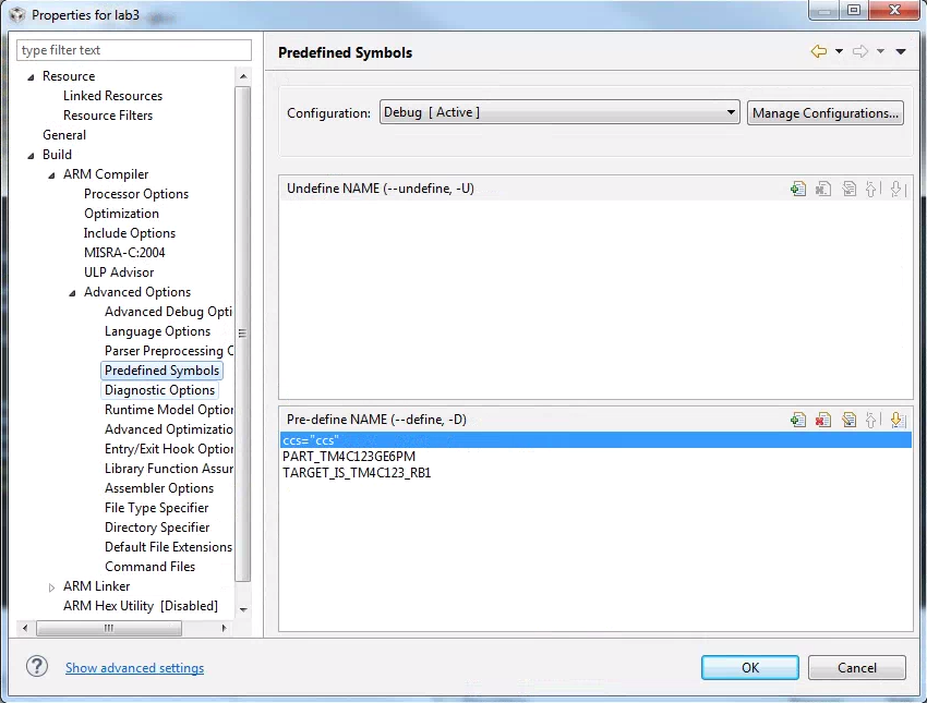

    1. Right click your CCS project and select "New->Folder". Go to "Advanced" and then select "Link to Alternate Location". Set the location to your "drivers" folder. Example drivers folder location "C:\EK-TM4C123GXL-KEIL-753\examples\boards\ek-tm4c123gxl\drivers".
    2. As suggested by Chester add TARGET_IS_BLIZZARD_RB1 at CCS Project Settings->Predefined Symbols.
    3. Go to CCS Project Properties->Include Options and add this search path "C:\EK-TM4C123GXL-KEIL-753\examples\boards\ek-tm4c123gxl". Change that to your folder location equivalent.

    From your posted pictures I can see the driverlib.lib is in Linked resources tab. It shouldn't be there. Remove that path and go to Project Properties ->Build->ARM Linker and you will find out a special location where to add libraries, and on the same tab, the path to be added.
    Take into account the Eclipse is not perfect, has problems with paths and is recommended to insert relative paths instead absolute ones. Can be done easy - right click on the path and choose to transform it to relative one.

  • Chester and Markel,
    First of all, I really appreciate your help!
    I've finally gotten it to work. The step that got it to work was to predefine symbol TARGET_IS_BLIZZARD_RB1. My question to you guys is: What is this, and why did it required?
    TARGET_IS_BLIZZARD_RB1 is a old name from StellarisWare, which in the later TivaWare releases was renamed to TARGET_IS_TM4C123_RB1.
    Looking back at your original post I now see that you are using TivaWare 1.1. I don't have that version of TivaWare installed, but expect that in that version the name TARGET_IS_TM4C123_RB1 isn't recognized and therefore you had to use TARGET_IS_BLIZZARD_RB1 instead.
    [This is a hang-over from when the Stellaris parts were "rebranded" to Tiva parts]
