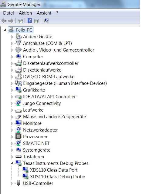

    This is what the device manager looks like when connecting the MSP432 board. I just connected it to the USB Port and did not do anything else.
    Whereas the device manager looks like this, when connecting the TM4C123 LaunchPad:
    If you need any further information please let me know and once again thanks for your help in advance!

  • I'm confused by your alternating quotation of "MSP432" and "TM4C". Which Launchpad you mean, and when ?
    My (older LM4C) Launchpad shows up in the hardware manager as "Stellaris In-Circuit Debug Interface".
    Have you installed the USB drivers ?  I'm pretty sure the MSP432- and TM4C are not the same, despite both being Cortex M4 ...
    I am working with a TM4C123GH6PM LaunchPad. While flashing it, CCS got stuck and afterwards it wasn't recognized by my PC anymore. Also it wasn't recognized by another PC.
    I do have a second LaunchPad, the MSP432P401R, which I never flashed, programmed or even touched before. To check if the problem is related to the USB Port on my machine, I connected the LaunchPad to it. What happened then was, that the example programm started working (flashing LEDs which change colors when pressing the Buttons). So the MSP432P401R is recognized as it should, whereas the other LaunchPad (TM4C123GH6PM) is not recognized anymore since CCS crashed while flashing.
    Now I am trying to fix the "broken" LaunchPad (TM4C123GH6PM) and make it visible again for my computer to work with it. The device manager was showing "Stellaris In-Circuit Debug Interface" before.
    Yes, I reinstalled all the needed drivers and also tried reinstalling CCS.

    felix could also simply check to see if the power LED is illuminated as a very quick check for this. If it is ON, then there is still the possibility of damage causing improper voltages leading to a need to verify the voltage levels with a voltmeter. If it is OFF, the first point I would check is the power select switch on the same end as the USB connector. This could have inadvertently been moved to the device setting while unplugging or plugging the USB debug cable.
  • Thanks Chuck,
    Thanks f.m.,
    sorry for the late response. I wasn't able to check the voltages over the weekend. Now I've done it and the pins deliver +3.3V or +5V as they should. The LED is on and the switch in the right position.
    So it seems like Chuck is right and the ICDI interface might be broken.
    Thanks for your help to the both of you!
