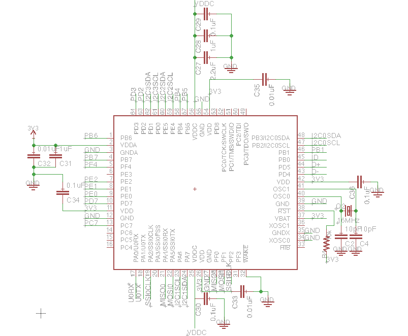

I'm a college student working on a project using TM4C123GH6PM. I built the schematic in EAGLE based on the datasheet for evaluation board but I still have some questions.
In the design guidelines for TM4C123GH6PM, it says:
Decoupling capacitors are typically 0.1 μF in value and should be accompanied by a bulk capacitor near the microcontroller. The combined VDD and VDDA bulk capacitance of the microcontroller is typically between 2 μF and 22 μF.
I don't really know what it means by "bulk capacitance of the microcontroller is typically between 2 μF and 22 μF" cause in the current schematic, the capacitance is smaller than 2 μF. And also, 2 of the capacitors are 0.01μF instead of 0.1 μF.
Does my shcematic look ok as the basic set up? I'm pretty new to microcontrollers so I'm not very sure.

  • Hello Sylvia,
    A bulk capacitor acts as a supply when there is a high current demand instantaneously before the power supply reacts.
    1. XOSC0 must be connected to GND
    2. JTAG does not show any connectivity. How do you plan to debug the device?
    Amit
  • Typically you have a low value capacitance in parallel to the standard decoupling capacitor for improved frequency response. 100nF paralleled with 10nF is fairly common.
    Note that the top diagram you show has a 2u2 capacitor as a local bulk capacitor.
    You end up with hierarchy of capacitors to keep the power supply steady. Small, high frequency near the device, larger lower frequency further away where inductance slows the response all the way to the regulator ant its capacitance.

  • Hi Robert,
    Do you mean that the 2u2 capacitor connected to VDDC can also count as the VDD and VDDA bulk capacitor for the microcontroller?

  • Hi Amit,
    So do I need to add extra capacitors or the ones connected to VDDC can also count?
    1. I think I connected XOSC0 to GND.
    2. I will make headers for JTAG. Thank you so much for pointing this out!

  • Hello Sylvia
    VDDC caps are OK. Make sure that for VDD+VDDA there is one 0.1uF cap per pin and an additional bulk capacitor.
    Amit
  • Hi Amit,
    But in the evaluation board schematic, there are two 0.1uF and two 0.01uF for 4 VDD pins. Should I change all of them into 0.1 uF?

  • Hello Sylvia
    The LaunchPad is not a product nor is it a reference design. You must refer to the System Design Guidelines document for a PCB design with TM4C123x device.
    www.ti.com/.../spma059.pdf
