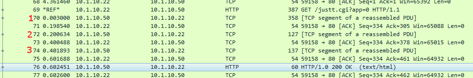

I request a '.cgi' file from the micro, which replies with an SSI with tags.  It works except that the reply (which is only 460bytes) get split into three blocks.
If I decrease the size of TCP_MSS in lwipopts.h then I can make it fragment into more blocks, but no matter how big I make TCP_MSS it always sends three chunks.
After some playing about I did notice that in httpd.c, tcp_write was occasionally returning with ERR_MEM, but I cant seem to find any memory settings in lwipopts.h that stop this.
