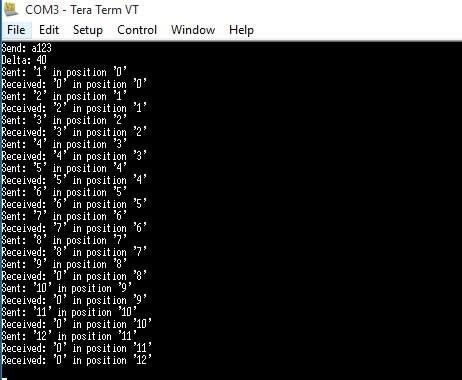

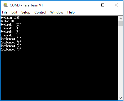

Inside the while routine to send data as Slave, the slave needs the clock wich is generated by master, so master keep sending some dummy data during it (this isn't ideal for my application but it was a suggestion from a TI employee and now I can finally send using Slave, ty).
This is what is printed on my serial port:

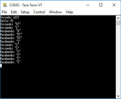

It seems like it loses the first data and repeat the third one because of that. Also, I tried to comment one line inside the while:
	while(ui32Index<strlen(pui32DataTx)){
		UARTprintf("Enviando: '%u' \n", pui32DataTx[ui32Index]);
		SSIDataPut(SSI1_BASE, pui32DataTx[ui32Index]);
		SSIDataPut(SSI0_BASE, pui32DataTx[ui32Index]);
//		SSIDataGet(SSI1_BASE, &pui32DataRx[ui32Index]);
		ui32Index++;
Because I think this line should be only inside the interrupt, but if I do this the interrupt is called 2 times and I didn't understand why this is happening.
So, I didn't have success on my attempts. Does anybody have any suggestion?

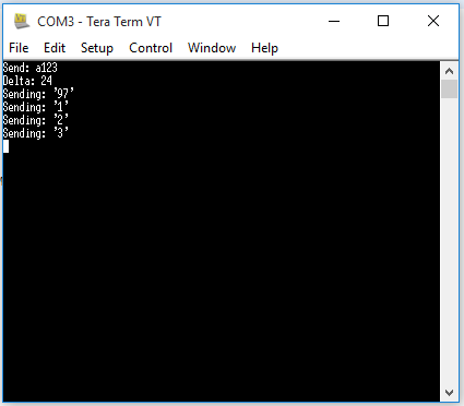

  • Hi Amit,
    I just changed the while routine as you suggested, but unfortunatelly the interrupt is never called now.
    Mayli.

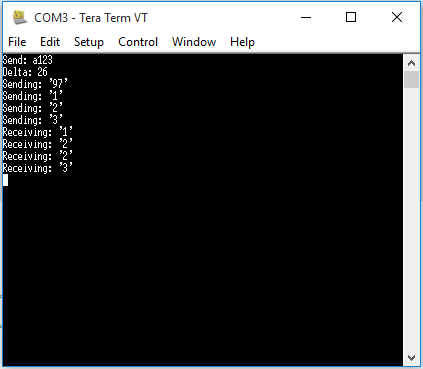

  • Hello Mayli
    I ran the code on the EK-TM4C1294XL and I see a fundamental problem
    1. The master and slave are both running on the same micro and hence there is a program interference due to use of shared variables
    2. The master send a byte and receives a byte from the slave. Then the slave writes a byte to the buffer. It is the next byte write from master that will cause it to be shifted on the bus. Thus at the end of the code execution a dummy write from master is required.
    3. Instead of using the RXFF interrupt bit, use the RXTO interrupt bit.
    I have made the modification to the project source code and attached the same

    I changed the following things:
    1- Now i'm sending 12 bytes :
         #define NUM_SSI_DATA            12
    2 - I commented the UARTprintfs inside the interrupt and inside the while routine.
    3 - I  used different index's for each module (master and slave)
    4 - I added some UARTprintf's at the end of the code to see what is in pui32DataTx and pui32DataRx.
          for (ui32Index = 0; ui32Index < NUM_SSI_DATA; ui32Index++){
    UARTprintf("Sent: '%u' in position '%u' \n", pui32DataTx[ui32Index], ui32Index);
    UARTprintf("Received: '%u' in position '%u' \n", pui32DataRx[ui32Index], ui32Index);
    Here is  the output:
    As shown in the previous picture, the last datas were lost.
    The full code is attached:
