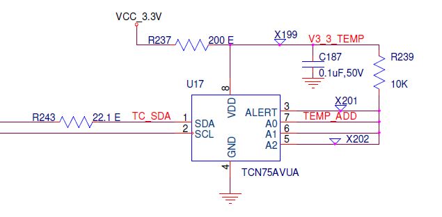

I2c Communication issue for RM57
I am trying to read TCN75A temperature sensor via I2c on rm 57 board. we have customized board with TCN sensor on board.
I took basic example to get started with

I am not bale to read back data from the senor. Please suggest if i missing something. Baud rate is used is 400 MHz .
H/w connect as below
