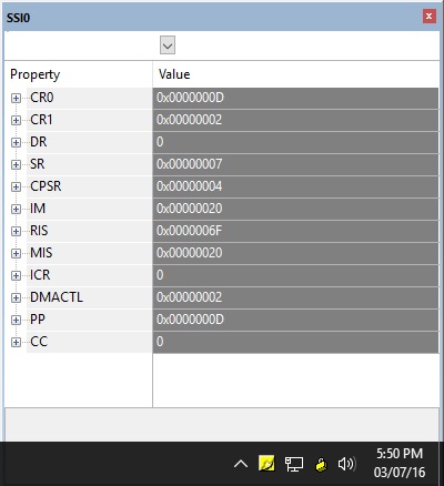

I'm using a TM4C129ENCPDT to transfer data to a DAC using SSI Ping Pong mode.
Looking at different logs, the SSI seems to go through all the sequence properly (alternating between Ping and Pong transfers) except after the last transfer, the SSI interrupt handler keep triggering endlessly.
I checked several posts but did not find a viable answer.
I"m attaching a snipped code and SSI registers after the last block has been transferred and the SSI handler has triggered.

SSIIntClear (SSI0_BASE, SSI_DMATX |
SSI_DMARX);
SSIIntEnable(SSI0_BASE, SSI_DMATX);

IntStatus = SSIIntStatus(SSI0_BASE, TRUE);
SSIIntClear(SSI0_BASE, IntStatus);

Please help.
