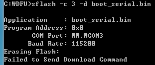

 The following  description Serial Flash Downloader  in SW-DK-TM4C123G-UG.
   i'm using by Example Source  in "examples\boards\dk-tm4c123g\boot_serial"  with DK-TM4C123G  Development Board
    it's  no Problem Connection COM3 (PC)  of  DK-TM4C123G Board (it's OK UART0)
    It was executed  by "sflash -c 3 -d boot_serial.bin" in DOS mode
    An error occurred.
       C:\> sFlash -c 3 -d boot_serial.bin
              Application : boot_serial.bin
    Program Address : 0x0
        COM Port : \\.\COM3
   Baud Rate : 115200
  Erasing Flash
  Failed to Send Download Command
It proceeded  as  below  SW-DK-TM4C-123G-UG.
why can not download  ?

  • Hello Jame
    Is the flash on the TM4C device already in erased state?
    Amit

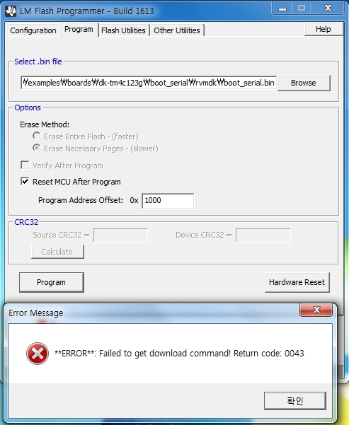

  • Hello Chuck
    It was updated recent LM Flash Program- Build 1613 and reading LMFlash Help
    I have tride download to DK-TM4C123G Board but An error occurred.
    Pop-Up Window "
    *** ERROR *** Failed to establish communication the board!
    Set LM Flash Programmer
    [configuration]
    Maual Configuration -see below, Serial(UART) , COM3, 115200, 76
    [v] disable AutoBbaud
    [Program]
    boot_serail.bin
    [v] Reset MCU After Program , program Address Offset 0x1000
    What should I do?
    thanks

  • Jame,
    You do not erase the device after programming Hello example before attempting to program boot_serial.bin via UART interface. The on chip ROM Boot Loader cannot work with the Hello example programmed into it already!!
    Second, you are attempting to load boot_serial.bin to offset 0x1000. This will not work. It needs to be at address 0x00000000.
    Finally, as I said before, you are not making any effort to change what you are doing or provide any debug related information. This is not helpful in solving your problem. You need to do these steps.
    1.) Erase the device using LMFlashProgrammer ICDI (ONLY Erase, DO NOT PROGRAM Hello Example!).
    2.) Program boot_serial.bin at offset 0x00000000 using LMFlashProgrammer - Your choice of UART or ICDI
    3.) Try your PC DOS tool to program hello example bin file to the device at offset 0x1000. Hello example should run now.

  • Jame,
    So far all you have shown me is the end result of failed communications with the device. Are you able to do any debug of the problem? In other words, do you have a debugger (CCS, IAR, KEIL, etc) where you can place break points in the code to see what is actually happening in the code execution? I have repeatedly asked for this and still only get screen shots of error messages which is not helpful. You need to examine the code execution and the UART signals to figure out what is going wrong. Simply identifying that it is failing is not allowing me to help you.
