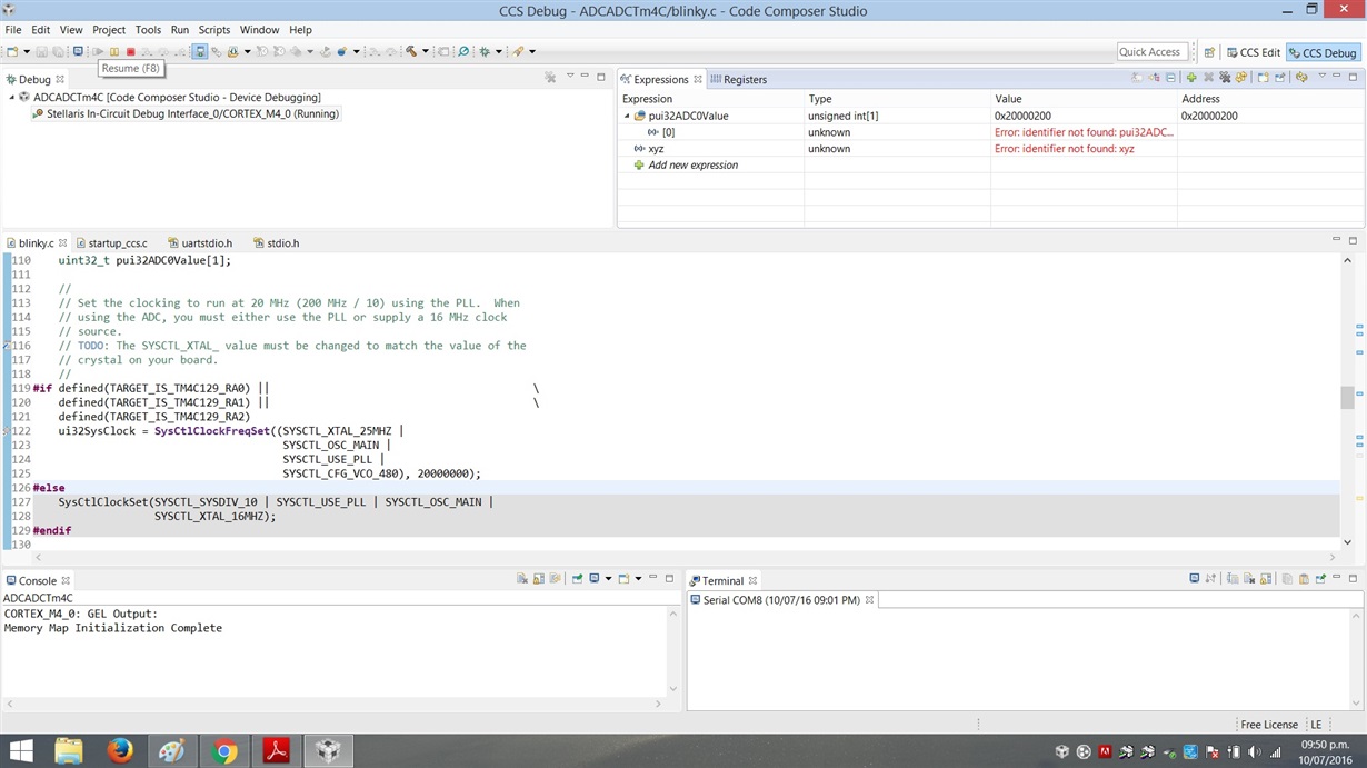

Hello, I just get a TM4C129exl launchpad, I load the blinky sample proyect and then I copied an ADC sample code from TivaWare,  the problem is that when I want to see the result from the ADC conversion after I "resume" the code I got this problem:

The UART does not seen to work properly, the terminal dont show me the ADC value, I have been working with the MSP432, and I use to declare the interruptions in the startup file for UART and ADC (not when using DMA), the ADC example from TIVAware tells me to not declare the interruptions in the startup, why??.

  • Hello Josue,
    If the variable is local to a function and the function is not in the scope of the execution, then the variable shall not be displayed.
    This particular example uses polling method to convert and report result. Using interrupt is 100% possible in TivaWare. ADC is normally a small part of examples, especially those using touch screen.
    If you put a break-point on the ADCProcessorTrigger function, then does it show that the breakpoint is hit? What does it show for the CPU execution?
    Amit
  • Hello Josue,
    In regard to the errors you are seeing in CCS, these are expression errors in the expression monitoring window and are not actually code errors. If you were able to compile and load your program to the uC there were no syntax, or undefined symbol errors in the code which would have halted the generation of the out file. If you want to watch specific variables, I would suggest using the watch feature not the expression feature. (note that the xyz expression doesn't even exist in the code that I can see).
    For your UART issues, I would suggest you try working with the basic hello or UART echo examples to get UART going prior to trying to implement the ADC code. Once you have UART communicating then get your ADC working and finally when both work, merge them together. The key here is take 1 step at a time and build on complexity once the base is working.
    For your question about interrupt configurations, TivaWare places this in the startup_xxx.c file so I am not certain what specific difference you are referring to. Note that the MSP432 device is another development team and the device as has a completely different architecture. The only common element is the M4F core so there will be many differences between TM4C and MSP432 programmers model.
    There are code examples for the ADC located in TivaWare at this directory location: C:\ti\TivaWare_C_Series-2.1.2.111\examples\peripherals\adc\. In addition, several of the examples make use of the ADC such as the ek-tm4c1294xl-boostxl-battpack example or the ek-tm4c1294xl-boostxl-senshub. The difficulty in providing a basic ADC example is controlling the external voltage input so, by including them in the booster pack examples, it provides the framework within a known environment.

  • Where are you stopped (Where is your breakpoint) when this happens?
    Robert
