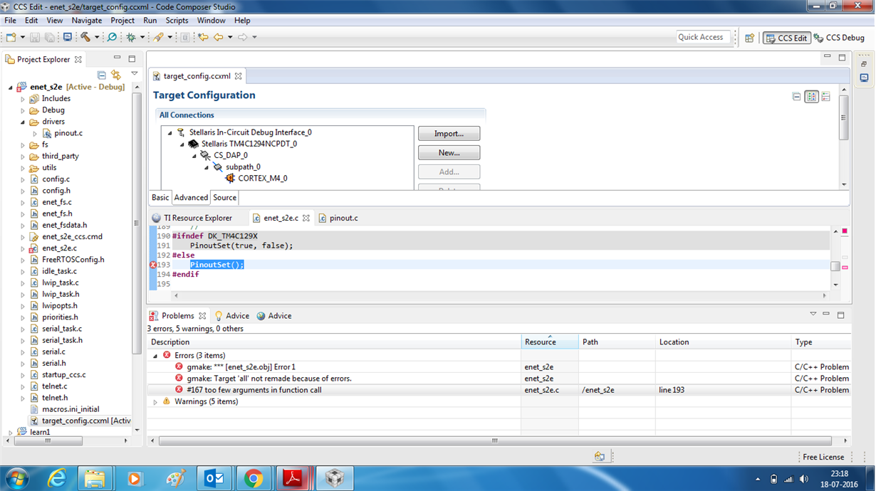

    I have made the suggested changes in the Files as suggested in the fourm. I was able to build successfully for EK-TM4C1294XL.
    BUT....Since i am working with DK-TM4C129X
    I made the following changes:
    (a) Replace the labels PART_TM4C1294NCPDT and TARGET_IS_TM4C129_RA1 with
    PART_TM4C129XNCZAD and TARGET_IS_TM4C129_RA0 in the project settings.
    (b) Uncomment the line that defines the label DK_TM4C129X in the enet_s2e.c file.
    (c) In properties -->ccs general-->Changed the variant and connection to tm4c129xnczad and stellaris icdi---since it dint get updated automatically
    (d)still showed error during build regarding pinoutset() function. The pinout.c file in the driver was still linked to the ek-tm4c129xl. So in pinout.c properties --> resources I changed the location as SW_ROOT\examples\boards\dk-tm4c129x\drivers\pinout.c .

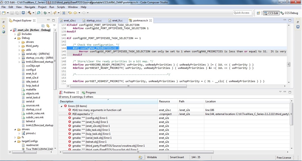

    (e)During build am facing the following errors
    (f) Made the following changes in enet_s2e.c

    (g)  Made the following changes in tm4c129xnczad.cmd
    MEMORY
    //FLASH (RX) : origin = 0x00000000, length = 0x00100000
    // SRAM (RWX) : origin = 0x20000000, length = 0x00040000
    and
    //__STACK_TOP = __stack + 512;
    (h) Deleted the file startup_ccs.c as there were issues regarding multiple declarations in startup_ccs.c and tm4c129xnczad_startup_ccs.c
    (i) changed __STACK_TOP = __stack + 4096; to __STACK_TOP = __stack + 512;  I am not sure if that was needed.
    Now I don't have errors, but i am doubful if this the right thing to do in terms of the utility of the application.

  • Hello Ayswaria,
    Did you copy the enet_s2e folder to the "dk-tm4c129x" folder? Most likely readon for the error in bullet (d) of your reply could be because the enet_se2 might still be in the folder "ek-tm4c1294xl".
    I would recommend, that you
    1) Do a fresh download of the s2e applciation.
    2) Copy the enet_se2 to the "dk-tm4c129x" folder and make the changes as per the readme.
    3) Then follow the steps in this forum post: e2e.ti.com/.../1923558
    If this still does not work, let us know and I will try to build it for DK-TM4C129X board.
    Sai

    The function PinoutSet(); shows error as its still linked to ek-tm4c129xl. Also  the targetcongif file still show tm4c129ncpdt as the part .

  • Hi sai
    I had uncommented that line as mentioned in the document.
    #define DK-TM4C129X
    But I had made an edit on this line as:
    #define DK_TM4C129X
    Because in the latter part of the enet_s2e program this was the varible used.
    It builds successfully if that edit is not made.
    But the pinoutset and targetconfig file is not linked to dk-tm4c129x.
