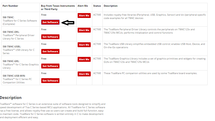

    I've followed a few different links to try and get the software I need, always getting to the same form in the end. I ran through it again using QJ's link and took screenshots:
    Following the initial link I get this, where I click the indicated link:

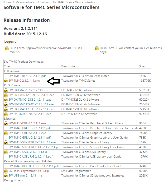

    Next, I get this page. As you can tell I've tried a few different links from this page. All of these others also led me to an identical form. For this run I tried the link indicated.

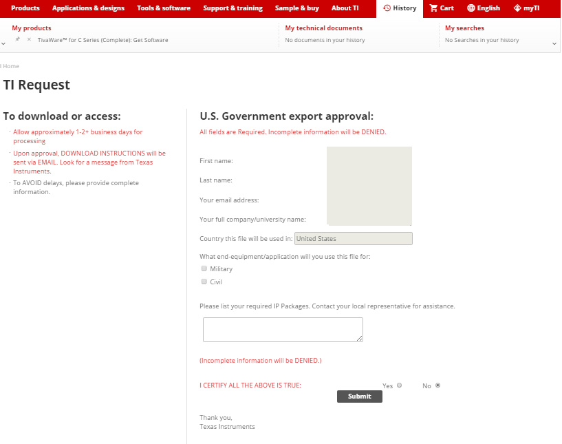

    After clicking that link, I get the US Government Government Export Approval Form.
    As you can see, it also says "Contact your local representative," but I'm not sure who that would be, or even which section of support to email from the "contact us" page, hence why I came here.
    I would also note that this isn't the only US Government export approval form I've seen downloading software here, but I do get this one when I try to get any of this Tivaware software.

    Sorry for all of the hoops you have to jump through for a simple download. Unfortunately, the export questions are necessary for legal reasons. I believe the question regarding IP Packages is merely a marketing hook to see what devices you might be interested in so they can target specific messages/content to you or have someone reach out to you. I would simply put the TM4C123 launchpad in the text entry field and be done with it. If there are other products in which you are genuinely interested, you could also enter them here has well.
    Let me know if this gets you through the screen and on to the download or not. By the way, I also agree that this is overly vague and, if truly not a legal requirement, then it is out of place. Unfortunately, it isn't something I have control over.

  • So I tried just putting "TM4C123 launchpad" (or something similar) and first got an email response saying this:
    We are unable to approve your Request due to incomplete information.
    Please note all information is required for approval:
    Confirm email. Provide a Company or University email address (Not @gmail.com, @yahoo.com or @163.com)
    So apparently they didn't like my gmail. I switched to my university email, and submitted the form again. Then did so again a few days later. No response ever came, and now its been about a month.
    WHAT ACTUALLY WORKED:
    So today I figured I'd try it one more time, then post an update to this thread, and noticed that the page with a bunch of links to the downloads had javascript disabled (I run my browser with javascript disabled by default). I enabled javascript, then clicked the link to the relevant download (now it's SW-TM4C-2.1.3.156.exe), and got a different, more typical export form. It just had the usual list of things to be aware of and a bubble to click saying you understood what it said. It then immediately approved the download.
    I would also note that before I made that change, the link showed the same form as before, so turning on javascript is almost certainly what made the difference. I'm guessing that the site uses javascript somehow to check information about where the download request is coming from, and that having it disabled lead it to use the more stringent form.
