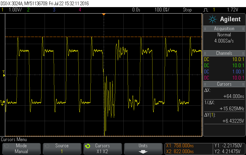

  • Ok, I have run the firmware with a scope connected and just a few minutes ago the scope triggered with a narrow pulse. The low signal level is noisy, too. And I checked and there was a duplicate byte error at about the same time the scope triggered.
    I have a screen shot saved to a PNG file. How can I get this to you?

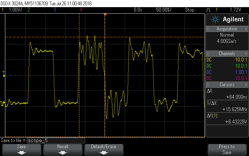

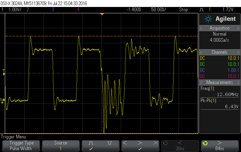

  • Here are the images:
  • Hello Marc,
    I was expecting a missing clock or elongated edge, but this seems that the clock frequency changed for no apparent reason. And this is the system clock on the DIVSCLK, right?
    Amit
  • The scope lead is connected to a wire that is soldered to the micro's DIVSCLK pin. BTW, this ouput is the PIOSC divided by 2. There apparently is no support for a divide by 1 output.
  • Hello Marc
    Yes, I do see 8Mhz based on the scope's horizontal resolution and the edges of the clock. But the multiple edges do not make sense. Is there a Crystal on your board. If yes then can you short the OSC0 pin to GND and if not then is OSC0 connected to GND?
    Amit

  • Hi Amit.
    An absence of a clock switching issue has not been confirmed. The scope trigger was set to trigger with a 64ns (or greater) high pulse. I have not set the scope to trigger with too narrow a pulse or (if the scope supports it) a "glitch".
    In one case the scope did trigger with a (barely) too wide high pulse and there was an error that at least was in the right time window as best I could tell.
    The scope trace did show a bit of a step/ledge on the falling edge of the high pulse which made the pulse wider, wide enough to trigger the scope.
    I have to point out the incoming byte stream is without the error -- the duplicate byte -- so it is unlikely the error bit capture will be of any real value. Besides the UART error interrupts are enabled and there is code to detect an error, count it, and to read the UART until the RX FIFO is empty, the read bytes being discarded. Since the duplicate byte appears it strongly suggests there is no RX error associated with this duplicate byte.
