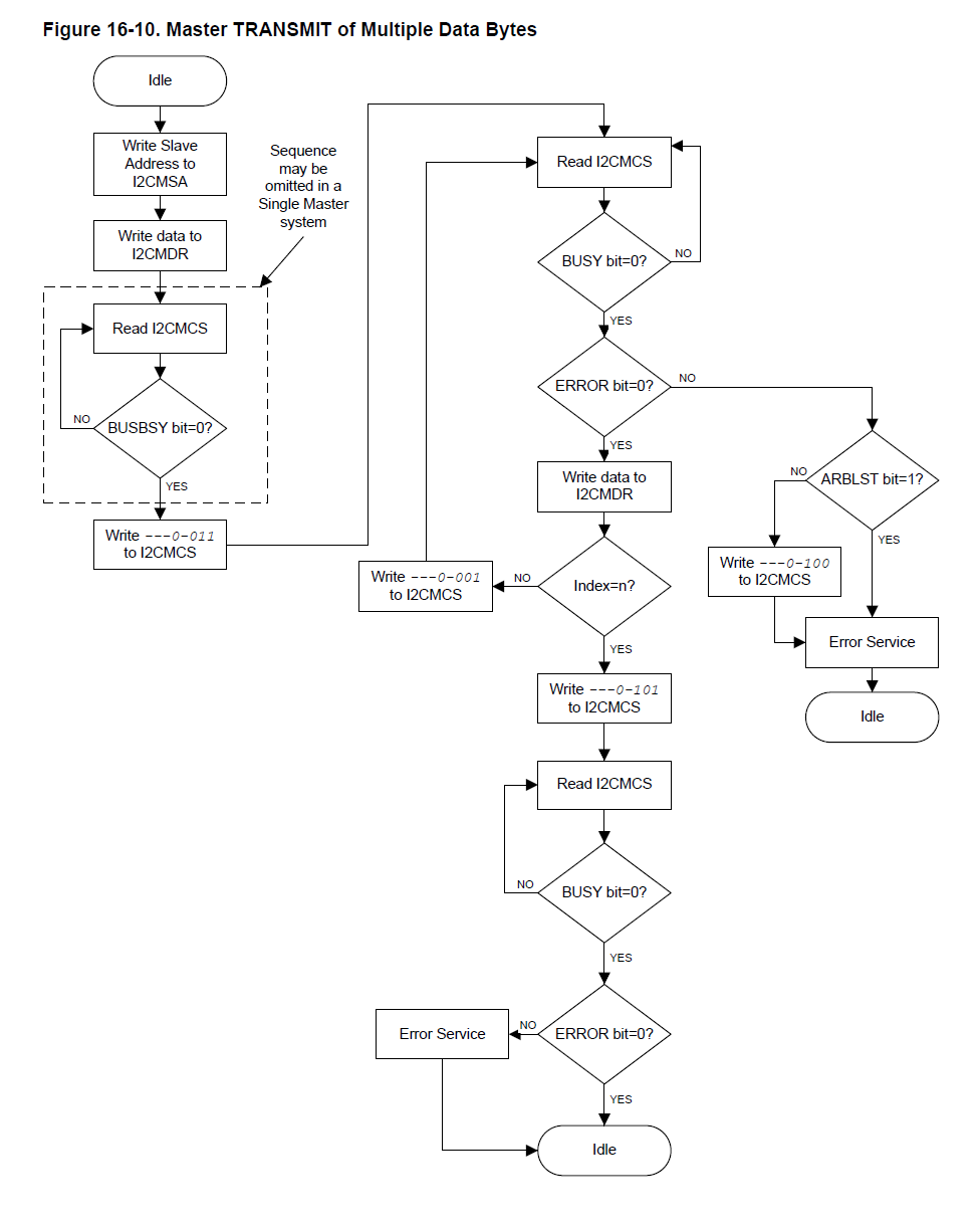

I'm having problems interfacing my TM4C MCU to a MMA 7455 accelerometer.
I continuelly receive the Arbitration Lost error.

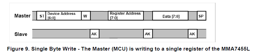

Fist I just wanted to write to the 0x16 register of the accelerometer to set it't mode and only after that to receive data from it.
But I have issues sending data.
I check the MCS register and no sign of setting the run / start / end condition bits (0,1,2).
Also the MDR register is always empty.
I paste here the function to initialize the I2C Master and the function to write data from the master (MCU) to slave (MMA 7455).

I2C Write Function:
unsigned char I2C_Write(unsigned char Slave_Address, unsigned char Register_Address, unsigned char Register_Value)
	unsigned char error_nr = 0;

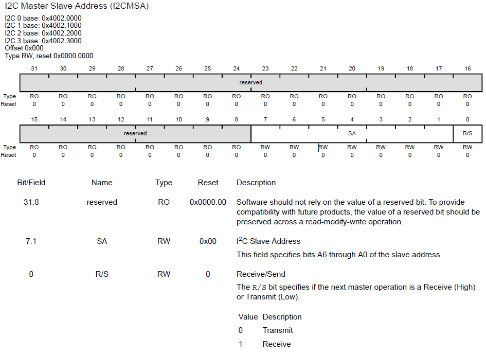

	//Step 1. Set Slave address and Write mode (R/W bit = 0)
	I2CMasterSlaveAddrSet(I2C0_BASE,Slave_Address,Master_Tx_Slave_Rx);	//Set slave address and send mode
	//Step 2. Send the 8bit register address to write to
	I2CMasterDataPut(I2C0_BASE, Register_Address); //Send the register address to the Slave device
	while(I2CMasterBusBusy(I2C0_BASE)){}
	I2CMasterControl(I2C0_BASE, I2C_MASTER_CMD_BURST_SEND_START);
	while(I2CMasterBusy(I2C0_BASE)){}
	error_nr = I2CMasterErr(I2C0_BASE);
	if(error_nr !=0)
		if(error_nr ==0x10)
			I2CMasterControl(I2C0_BASE, I2C_MASTER_CMD_BURST_SEND_ERROR_STOP);
		return 0; //Error Service
	else
		//Step 3. Send data to write on register
		I2CMasterDataPut(I2C0_BASE, Register_Value);	//Send the register value to the Slave device
		I2CMasterControl(I2C0_BASE, I2C_MASTER_CMD_BURST_SEND_FINISH);
		if(error_nr !=0)
			return 0;
		return 1;

    Specs are often confusing here - does this address need a shift to accommodate for the R/W bit, or not ?
    - From the I2CMasterErr I keep receiving 0x0C (I2C_MASTER_ERR_ADDR_ACK and I2C_MASTER_ERR_DATA_ACK)
    This would suggest an address issue. But without scope/logic analyzer, you are more or less limited to trial-and-error ...
    Could you detail this?
    Are you referring to, how the slave handles write commands?
    I will quote from the MMA7455 datasheet:
    To start a write command, the Master transmits a start condition (ST) to the MMA7455L, slave address ($1D) with the R/W bit set
    to “0” for a write, the MMA7455L sends an acknowledgement. Then the Master (MCU) transmits the 8-bit address of the register
    to write to, and the MMA7455L sends an acknowledgement. Then the Master (or MCU) transmits the 8-bit data to write to the
    designated register and the MMA7455L sends an acknowledgement that it has received the data. Since this transmission is complete,
    the Master transmits a stop condition (SP) to the data transfer. The data sent to the MMA7455L is now stored in the appropriate register.

  • Could you detail this?
    Having read datasheets of different I2C slaves, the addressing seems not consistent. As you know (I hope), the LSB of the address is reserved to differ between read access and write access. Thus, each device actually occupies two addresses (from a "bus" point of view).
    Often, I2C peripherals in MCUs explicitly specify a "7 Bit I2C address". This implies a shift (1 bit left) and automatic setting of the R/W bit, depending on the access mode (read or write).
    Now, how does the slave spec. handle this address (0x1D) ? Does this value include the R/W bit, or not ? If you read "7 bit address" anywhere in the spec., it most probably implies a left-shift. And since the value 0x1D has the LSB set, I guess it <is> a 7-bit address ...
  • I'm not sure about this.
    Yes, it's a 7 bit address, but the 8th bit in the slaves register is the SPI / I2C enable bit.
    As I see in the TivaWare I2C API, the I2CMasterSlaveAddrSet functions already shifts the slave adress to the left by one.
    HWREG(ui32Base + I2C_O_MSA) = (ui8SlaveAddr << 1) | bReceive;
    On my MCU, indeed the register for the slave adress also contains on bit 0 the read / transmit bit, but on the slave register not... I don't know how this is / could be handled.

    I don't think so. Both seem to specify/handle the address in the same way. The only (and confusing) thing is - when you watch and decode the address bit transfer, you read 0x3A (or 0x3B) on the bus, i.e. left-shifted by one bit. But you don't have a scope/analyzer yet, so no danger ... ;-)

  • In the meantime, I suggest to check if the "repeated start" condition is missing.
    After writing the register address, a "repeated start should follow, than the device address again, and then the actual read.
    When running in the debugger , it should IMHO be possible to stop after the register write, and use a voltmeter to check for the stop condition.
    Most I2C devices are static designs, and don't have a time limit for such conditions.
    How to achieve a "repeated start" I would leave it to the TivaWare experts.
    According to the TM4C datasheet, you just need to transmit a "start condition" again, without preceding stop.
