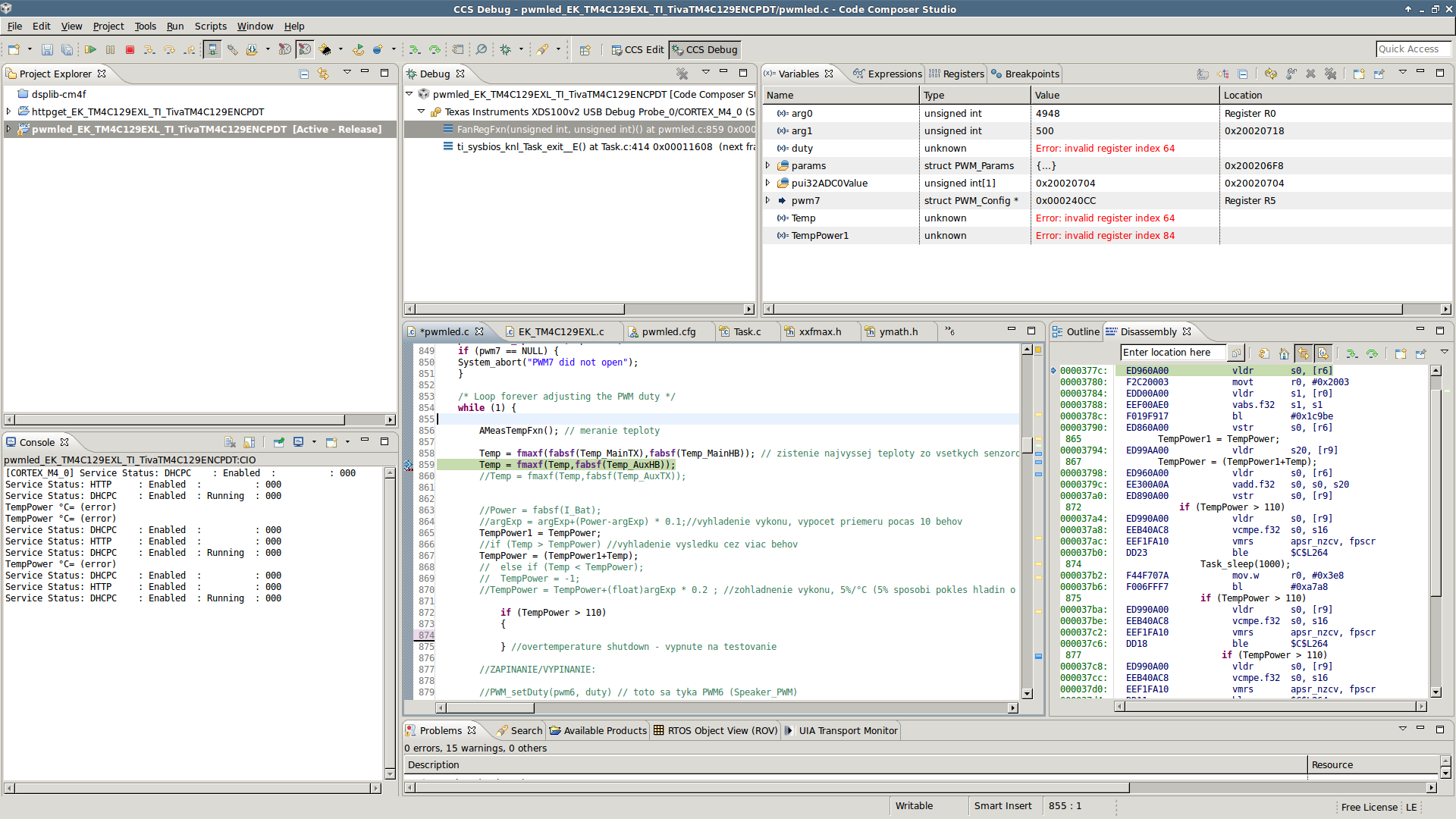

Hello, I came on a strange problem with variable in TM4C129 TI-RTOS project.
Consider this function:

The function is to measure four temperatures, get the highest of them, smooth it out and set up fan speed accordingly. If temperature is too high, turn off the system and set error code.
Everything works, except the smoothing of the values. This is an inverter project and at higher powers, I get some noise at the thermistor lines that needs to be removed. The simplest way I thought of was to take 9/10th of the old maximum temperature (TempPower variable) and one tenth of new maximum temperature (Temp variable):
TempPower = (0.9*TempPower+0.1*Temp);
But when I do that, or anything similar, I get an (error) instead of the expected value. Also, when I debug and break before that point, I can not Step Into that. It just skips over that row. I tried to modify it in a way that I do not read and overwrite TempPower on the same row:
float TempPower1 = 0;
    	TempPower1 = TempPower;
    	TempPower = (TempPower1+Temp);

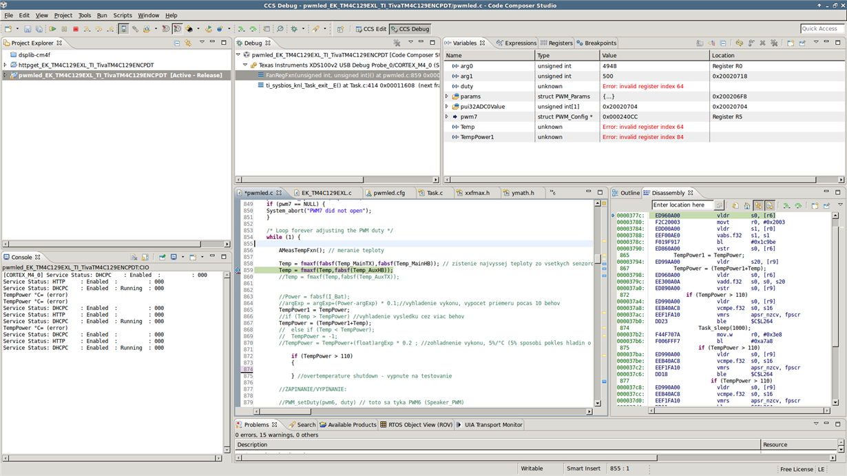

But still the same problem persists. And on the Variables view, there are these red warnings about invalid register indexes. What is causing them?
I do similar averaging with voltages and other variables in other function and it works as expected.
What could be the problem here?
Thanks in advance for help.
    What do you mean by error?
    Robert
  • Dear Robert, I would also like to know what the MCU means by that. I can see only what is displayed on the console in the attached screenshot, and the red Invalid Register Number warnings.
    Even if I list it on the webpage served from the MCU, the same string "(error)" instead of a number appears.

  • Robert, I got your point but don't worry, I am not that stupid. Yes I am breakpointing, but this is safe - HW is only a control board with sensors but no power stages attached. And in any case I have set the MCU to inhibit PWM outputs when debugger halts it.
    Please let's get back to my problem, I believe it has nothing to do with breakpoints or debugging methods.
  • If I understand this correctly, when I define something at the beginning of the file, i.e. before any Tasks or Init or Main, it is global, not local. So my variables are defined at the beginning of the file. For the reason that I need to access most of them from more than one task.
    So in this FanRegFxn task for example, I take those four temperatures which are measured by ADC routine in another task, every second. I could use another method maybe it would be more efficient, but hey it works and it is simple.. Only problem I need to solve is with the TempPower variable in this FanRegFxn task ...

  • Robert. There is nothing to log, since the very first time I try to modify the TempPower by doing some calculation, it outputs that Error.
    Only thing that can be done is to assign the TempPower the value of some other variable, like
    TempPower = Temp
    and even TempPower = Temp + Temp works.
    But as soon as I, for example, do TempPower = 2*Temp , I get that Error.

  • PROBLEM SOLVED!
    Robert, I thought again about your advice to log. I noticed that even when I do TempPower1 = Temp the first value is Error. Next values however are OK. So I also uncommented my other System_Printf's for all four input temperatures. And, surprisingly, they were all errors at first cycle! I did never notice this in real life, because it happens on power-up only and I need to actually switch the device on with a button to start the power electronics which generate heat and needs to be cooled by that FanRegFxn().
    I realized that this is Task0, and even there are higher priority tasks in the RTOS, this one would run first and will use the ADC as first one. So I simply added a Task_sleep(1000); before the while(1) loop in FanRegFxn() and now I have very nice readings with all temperatures are averaged:
    [CORTEX_M4_0] Service Status: DHCPC    : Enabled  :          : 000
    Service Status: HTTP     : Enabled  :          : 000

    Voilla! For some reason the ADC needs some time after its initialization before outputting reasonable values. And since my filtering always takes previous values, the errorneous first value got perpetrated to all subsequent, wannabe-averaged values.
    Thanks in advance Robert! You pointed me in the right direction.

  • You are assuming that error is not just an artifact of the IDE or the way you are using it. Logging will show you what is happening, most importantly it will give you a 'real time' snapshot with the real feedback something that breakpoints cannot do. And since you already have print statements working it's simple to add.
    Robert
  • Have you waited for the a/ d to finish initializing before usin
    Also, your sensor output circuitry may need time to stabilize, as could your references and analog supplies.
    Robert
  • Ahem, before using it?
    Robert

    Analog circuitry would not be a problem - it is all simply thermistor - resistor voltage dividers. Referecne ditto - the board is up for several hours now ..
    I think it just needed some delay or something ... glad it is solved, it had puzzled me for a month or so.
  • Notice there's no check in the init to verify completion.
    All analog and thermal circuits have time delays. From your description I'd be worried about impedance matching as well. A/ds are not high impedance inputs, they will be affected by resistor chains and dividers.
    Robert
  • Search the tag bookshelf for some references on the care and feeding of a/ds.
    Robert
    nothing can be considered solved until you understand the root cause. Maybe only tentatively then
  • Yes, this TM4C does not have buffered ADC inputs and at first, its rather low input impedance was a problem. But as I do not need very rapid measurements, lenghtening the S&H window solved this so now I have a measurement error under 1% on all inputs. Solved long time ago.
