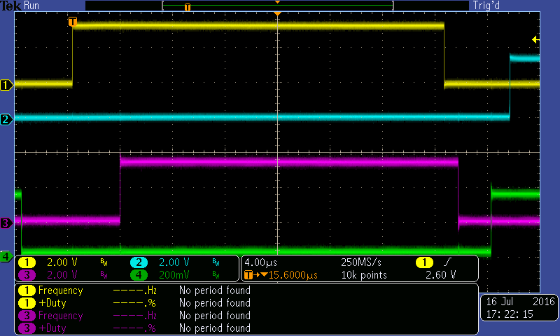

Recently the claim was made here that (only) one PWM Generator could produce proper, Complementary PWM Signals with protective Deadband.   Poster reported that when his 2nd PWM Generator was enabled - it produced a badly distorted (runt) pulse upon the "deadband" PWM output channel.
Firm/I exchanged w/this poster - advised that he try to reduce his issue to the minimum code which evidenced the effect.   That request remained unheeded - the scope cap below reveals TWO PWM Generators (w/in the same PWM Module) with both Generators producing well formed, and Deadbanded, PWM Signals.
Top 2 channels reveal deadband w/200 as lead/lag parameters, bottom 2 channels employ 100.   No "runt" or other deadband distortions appear.   These results were achieved upon both an LM3S16xx AND an LX4F2xx MCU from this vendor - in each case using the StellarisWare API - which of course (most always) leads to such success...

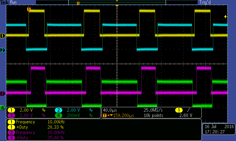

  • Again, greetings.    Let the record show that our "PWM/Deadbanding, Protesting Poster" would not accept the screen caps (kindly) provided earlier here (above) - and "moved the cheese" - seeking "New Caps" with two different parameter values.   Not one to "duck such challenge" the new screen caps (once more) demonstrate vendor's TM4C123 MCU to "CONTINUE" to perform to spec!   (note that LM3S16xx and LX4F23x also performed to spec!)
    Protesting PWM Poster has been asked - repeatedly - to provide the shortest code blurb which demonstrates his (claimed) "BREAK" of PWM_B when deadbanding.   (poster claims "runt" or other distortion - which has NEVER been replicated by poster "Source 2" or this reporter.
    Suspicion must fall upon protesting poster's set-up and/or config of PWM and/or deadband.
    Presented (below) is PWM_B (CH4, green) w/parameter LAG > Lead.   NO Issues noted.

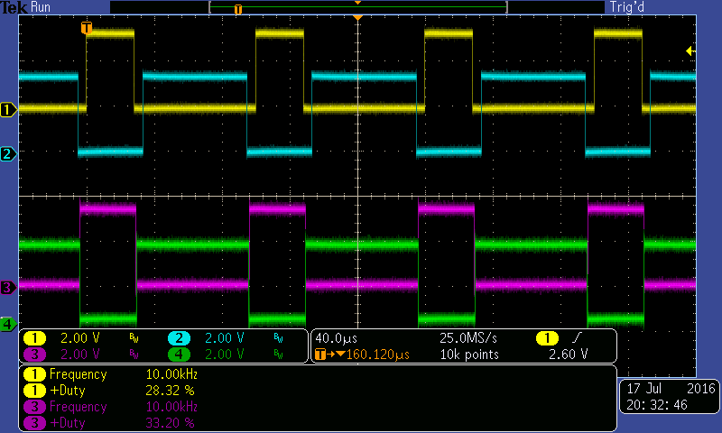

    And here - Lead > Lag.   Again - NO Issues.

    It appears prudent for "protesting poster" to re-examine his code - and "work-arounds" as several here have been unable to replicate his (strange) findings...
    Any fair review would note vendor's PWM (under deadband) to fully & properly maintain specification...   (we continue to "welcome" poster's, "smallest code blurb which "Breaks" this PWM under deadband.")   (history of Rome - multiple incidentals - NOT so much!)
