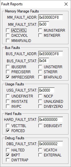

  • 0xE000ED28: 0x00000400
    0xE000ED38: 0xE000EDF8
    I'm including the fault report provided by Keil/uVision tools

  • Hello Khaled
    Since it is an Imprecise Bus Fault, you need to check the value of the CPU registers, assembly instruction being executed and which location it is accessing. There is no alternative other than to debug.

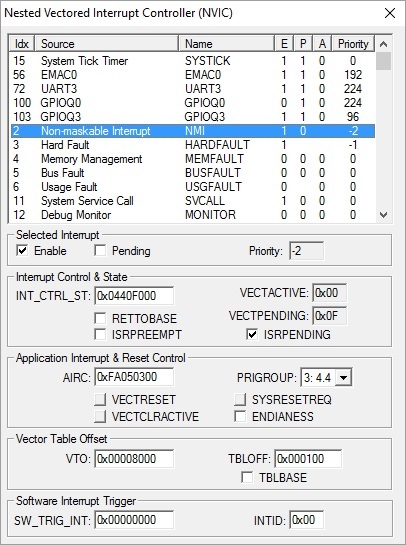

    It has to do with an EMAC interrupt that was pending and was serviced before I got the chance to enable RTX. I'm attaching the NVIC snapshot.
    Khaled.

    So, as a test, I kept all the code enabled and physically disconnected the Ethernet plug, but the hard fault still triggered ==> the interrupt is not generated from the PC! I even checked the NVIC table and there is no pending interrupt from Ethernet when the Ethernet is unplugged. But a UART3 interrupt is pending although I have no physical connection to that port!

  • Yes systick is enabled (see NVIC snapshot from 11:28).
