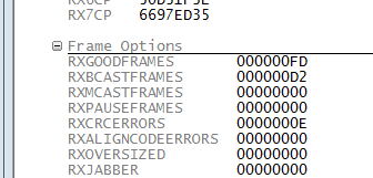

A customer reported issues with the EMAC module on RM57. They like to upgrade their current system from RM48 to RM57 for this they simply produced new boards with RM57 on them instead. Now they started to see that they lose some packets, they reported a packet loss of 5-50% depending on the board with identical SW. The Ethernet driver is the same between RM48 and RM57.
The packet statistics showed that the amount of lost packets equals the amount of CRC errors:

    They did some more tests including enabling the RXCEFEN (Receive copy error frames enable bit) mode, where the EMAC also copies corrupted frames (CRC mismatch) into the RAM buffer. From this they saw that several bits in different bytes in the corrupted frames are flipped. Any idea what could be the reason for this? As said the setup is the same between RM48 and RM57, the RM57 boards are even the same as for RM48 just with the devices swapped. Can this be a timing issue in the sense that RM57 is more sensitive than RM48?
