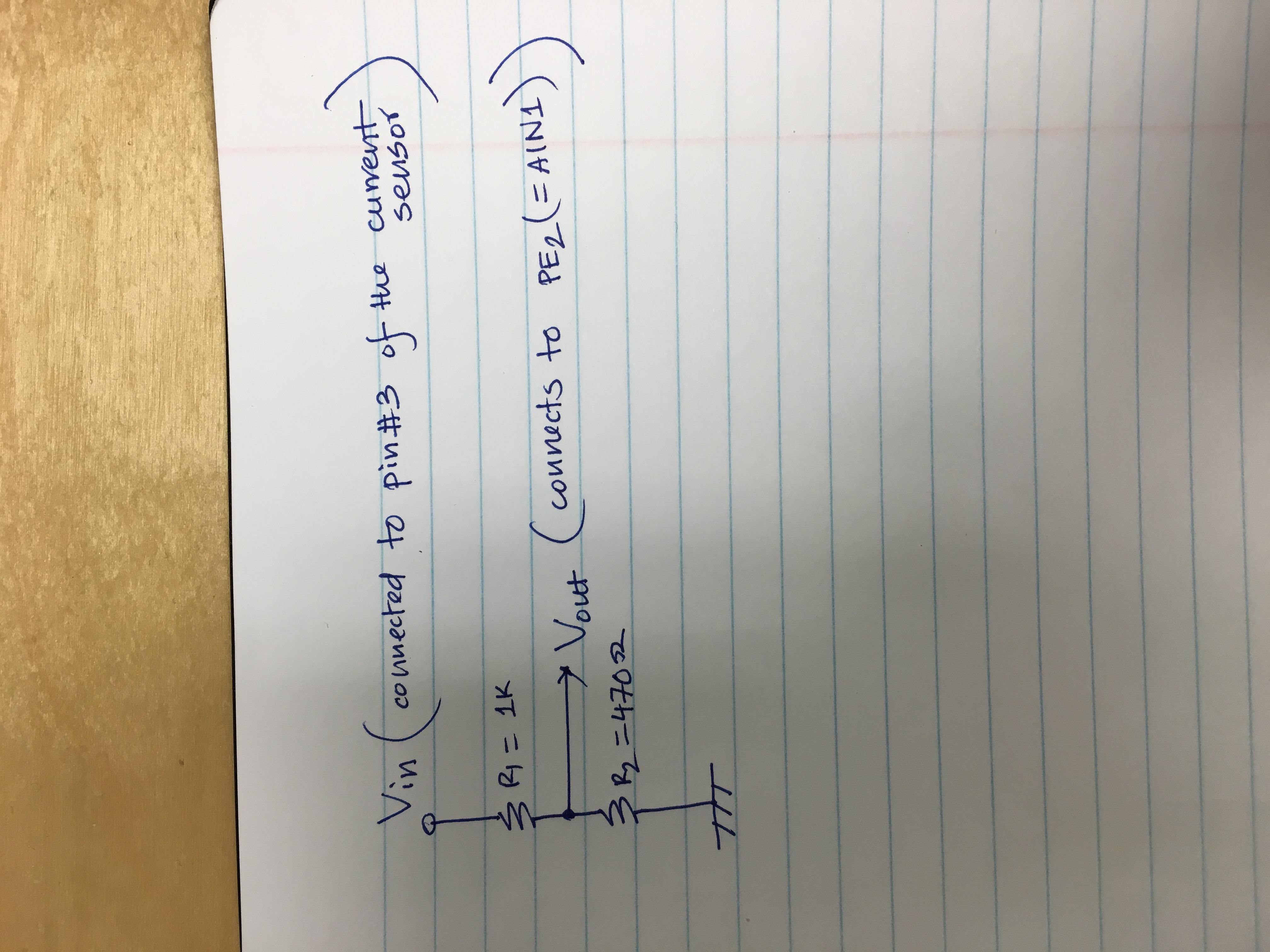

  • OK, so based on the suggestion, I did below. Not sure if I am doing it right.
    How does the ADC know that I am connecting to the PE2 pin? The code doesn't seem to reflect that. What am I missing?
    1. Connected the current sensor to the TM4C123 like below
    Pin#1  Uc -> VBUS (5V)
    Pin#2 OV -> GND
    Pin#3 Vout -> Input to the voltage divider (below diagram)
    Pin#4 Vref ->3.3V
    Pin#5 OCD ->GND
    The output of the voltage divider goes to PE2 (AIN1)
    2. Code to read the sensor following Tivaware document (http://www.ti.com/lit/ug/spmu298d/spmu298d.pdf)

  • You're right, you need to set up the pins. The Tivaware a/d examples should show how that's done.
    The divider is a start although your max voltage is now around 1V7 centred around 0V8. You should also be adding some filtering and impedance matching. Take a search for the bookshelf tag, you will find references to TI literature on developing inputs to A/Ds
    Robert
